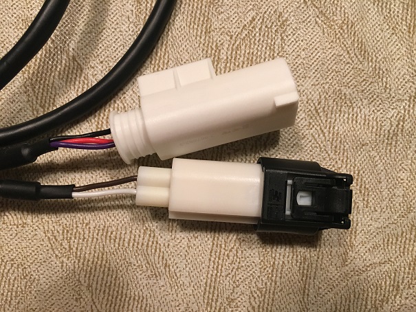

Has anyone adapted the 4-Button Garmin/NAV cradle so that it can be used on a different (non-BMW) motorcycle? When I received my NAV V, back in 2015, it came with 4-Button cradle, complete with the wiring harness to easily plug it into the wiring harness of a GS. As I have an RT with the in-dash GPS mount, I didn't have a use for the 4-Button cradle. Now I'd like to put a DIN connector on the cradle so that I could use the same GPS unit on a different motorcycle (one equipped with a Powerlet plug direct to the battery). I'm tired of using two different GPS units on having to remember how to for each unit. I'd much rather use the NAV V on both bikes.
The 4-Button cradle comes with 2 connectors coming from a single pigtail from the backside of the cradle. This single pigtail splits into two sets of wires, on set has two leads, a purple wire and a white wire (which I'm guessing is the power connector), and the other set has three wires, a purple wire, an orange wire, and a black wire. I'm guessing the purple wire is a ground, since it's the only common color between the two leads, but I don't know for sure. Which two wires do I need to connect to the DIN (Powerlet) plug?

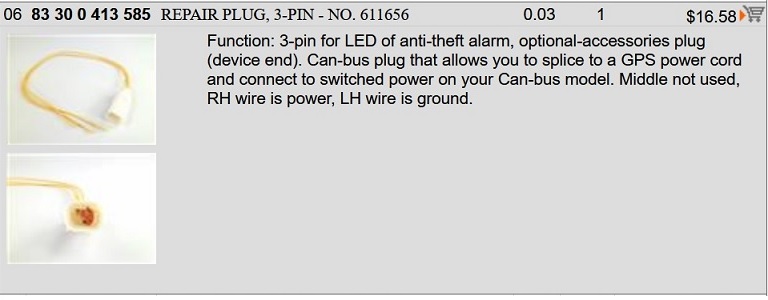

The three-wire plug on the 4-button mount supplies power via the two outside pins. The two-wire plug is used only on bikes that have an onboard sound system, so can be disregarded. Your connectors should look similar to this:

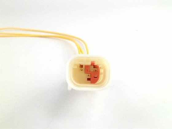

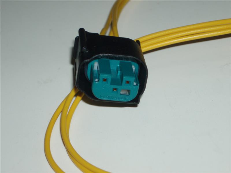

How you connect it depends upon whether or not you might someday want to use the mount on one bike only, and plug it into the harness on that bike. If you wish to preserve that capability the easiest way to connect is to purchase the harness-end repair connector, which is the connector that the 3-prong plug of the mount plugs into. That part number is 83 30 0 413 586 and looks like this:
The 586 repair plug can be wired to your male DIN plug, then the mount harness plugged in. Once the wiring is all neatened up your mount can them be jumped bike to bike and powered via a DIN socket.
You can wire up the 586 adapter following the comments for the 83 30 0 413 585 repair plug on the Max BMW website. That plug is the same one already at the end of the cord on the mount. Be careful to note which pin socket attaches where, when the two parts are plugged in together, so you get polarity correct.
If you don't plan on ever plugging the mount directly into a harness, you can always just cut off the three-prong plug on the mount harness and feed the outer wires into a male DIN plug. The buttons will work fine either way, you just won't get the data screens you'd get with the mount plugged directly into the harness on the bike. The comments in the picture above should let you know which wire is positive and which is negative.

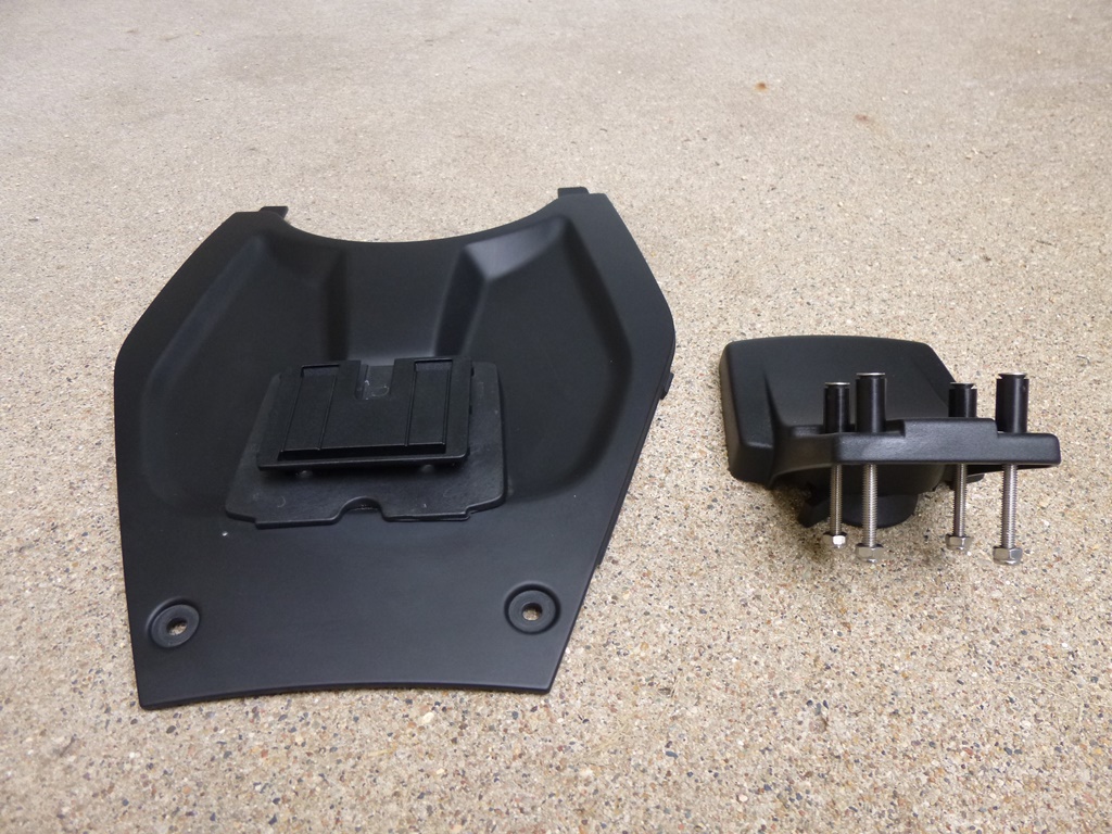

Does anyone have any good advice for attaching a Nav4 cradle to the battery cover of my K1200S? It can be a bit tricky, if I remember correctly, but with a bike that age, it is hard to find any resources for how to do it.
That diagram shows the mount BMW sold for the Nav IV on that bike and IIRC is designed as a clip-in mount for that GPS, which won’t match what you need for the 4-button. But since the 4-button cradle uses the standard AMPS mount hole layout you may be able to attach an AMPS plate to that bracket.

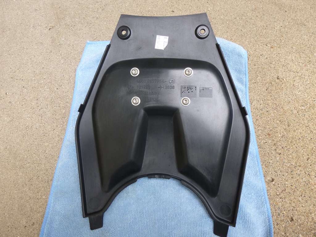

When I had the K1300S someone gave me a BMW Zumos and the mount that attached to the battery cover.
I always used a tank bag so I didn't use the battery cover mount.
Here's the mount.
It looked easy to mount.

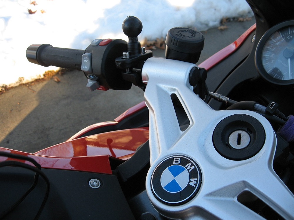

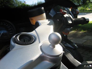

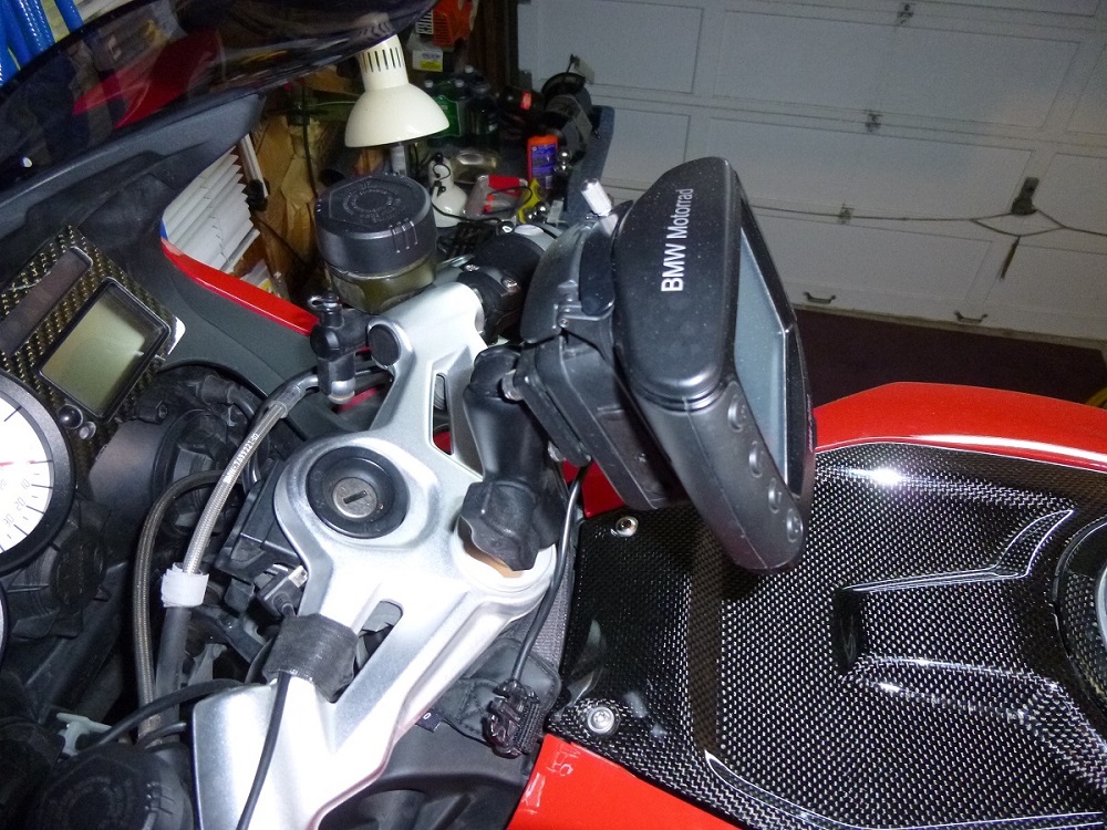

At first I used a Ram ball mount, then later a ball that mounted where the Roundel is.
Getting power was easy because the bike comes with a plug for the GPS by the battery.
I just had to buy the other half of the plug.
This is the Ram Ball by the left switch-gear.
