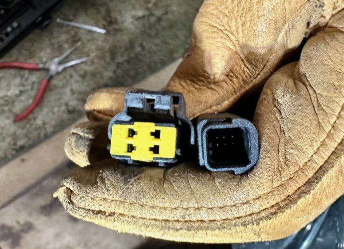

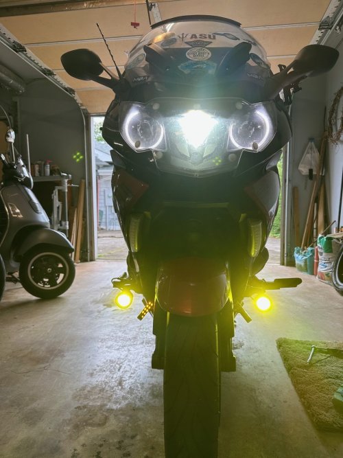

It took two tries, but I finally got the Ruby Moto Lights (4 ea LED lites) installed, I had to request the correct interface cable for my model of K16 versus the cable originally shipped. Now I’m feeling up to another 100,000 miles of pulling the camper to rallies around North ‘Merica...
