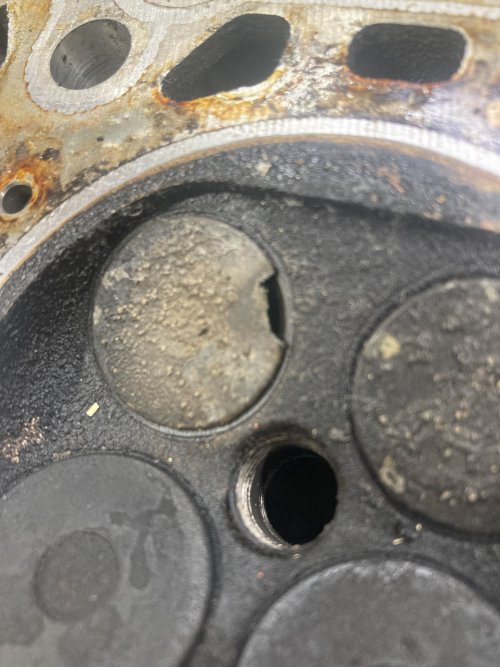

We had a tech session on Saturday Jan 18, to take the engine apart to see why i had no compression on cylinder #3. As I expected it was a bad exhaust valve.
The engine had about 126K miles when this happened. AnIMG_7695.JPGy ideas what would cause this?
The engine had about 126K miles when this happened. AnView attachment 100063y ideas what would cause this?

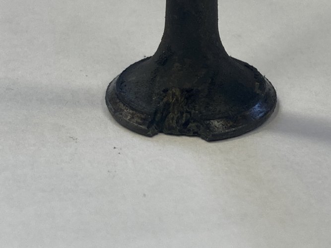

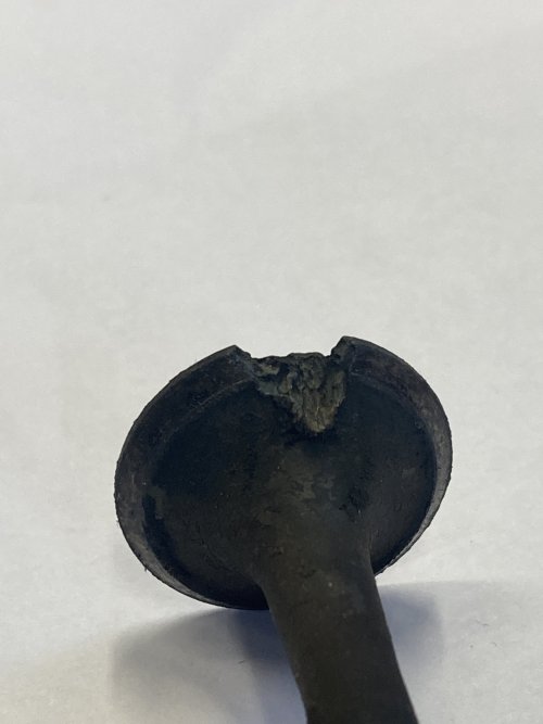

I think the last time I saw something like that, I figured a piece of carbon got stuck in the valve seat area allowing combustion to erode the valve seat. 126K is a lot of miles in which a lot can happen.
Here are a couple of photos of the bad valve. It certainly looks like something was holding the valve open and allowing the exhaust gases to erode the valve seat. The color of the carbon deposits on the cylinder head and valves doesn't seem to indicate it was running lean.
