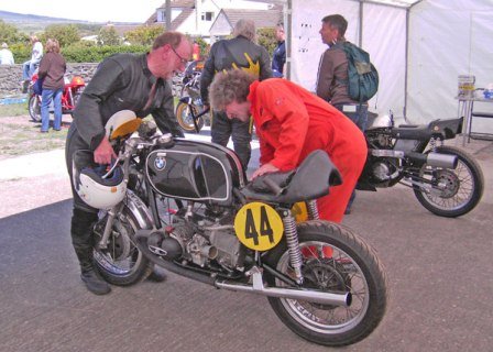

brother in-laws bike
its a Hans-Otto Butenuth special.
Looks like the general concensus is to turn it into a cafe racer.
Larry my brother in law has the Buthenuth motocycle now see pic. (he still races 60+ years old) currently at the TT now. So I should be able o get the specs, and understand the set up.
http://www.worldofbmw.co.uk/content/printArticle.asp?article=718
I have a vision of building it up just to try in the TT old duffers race and surprise him one year.
http://www.bmwmoa.org/features/bmw_sports_boxer.htm?pg=5
Check out the TT race, looks like fun.

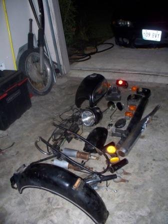

Bike in two piles now - parts 2 sell & base project
Parts to sell (took 4 hours to take these off

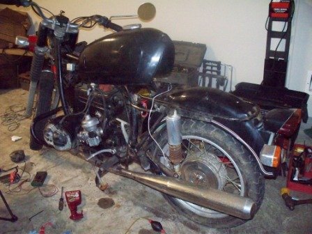

The base project cafe racer
Tomorrow or perhaps Wednesday, the chop.
Intend to cut the top of the engine housing off that houses the starter and the the diode pack to give the engine a flat look. (it has a kick start which should be sufficient.) Starter will go in the to be sold pile.

Toaster tank
Yes,
It has no dents but needs seriously cleaned out. The taps are year old.
I am restoring a '72 r60/5 and am in serious need of the front turn signals and stalks for them. How much are you looking to get for those? And i dont know if they are still available but how do the chrome panels on tank look and how much are you looking to get for those?
Cut the rear passenger pegs off.
Decided to keep the stands for the time being.
:scratch
Wouldn't it look flat with the starter cover installed? I guess you will trim a few pounds with this modification, but it sounds like a lot of work during the build (modifying the timing chain cover, wiring harness and front engine cover) and extra work every time you want to ride. Your project and your money. If you go that way, post some pic's of the modified parts. Good luck on your project.

He had better have a knowledgeable guide or a very good working knowledge when he takes the Sawzall to the front inner casting. Otherwise he will have turned a good parts bike into almost nothing.
