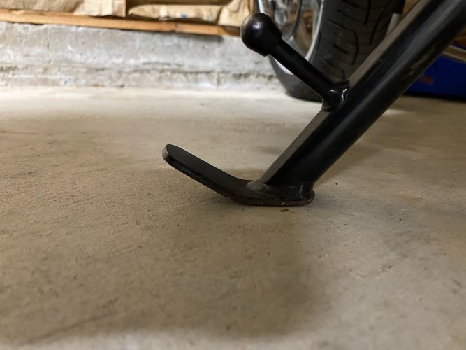

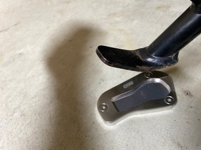

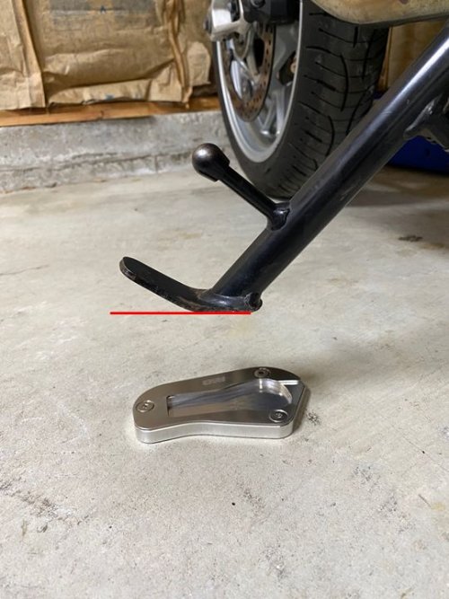

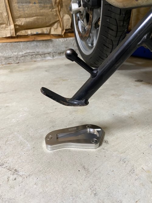

I have a 2015 R1200RT which I purchased this spring. I just bought a kickstand pad for the side stand, but it's not fitting. Is the foot of my kickstand bent? Is it supposed to be like this? If not, is it possible to bend it back, or will that brake the foot (will the metal fatigue)?
In the pictures it looks like you have the bike on the center stand. If you put it on the side stand, does it still have that "bent" part in the air? Based on the photos, it almost looks like the "toe" of the stand will be flat on the ground.
I found this picture of a '15 R1200RT and it appears that the pad of the stand and the small bar for foot action are not at the same angle. It seems like your pad and bar are almost nearly angled the same. I suspect yours is bent. Also, if you draw a line along the part of the pad that is welded to the upper stand, it would seem it would be bent.
Is it possible to bend this back without it making the metal weak along that bend line? I see used ones on eBay for $50-80.00...but "free" is a lot nicer...
That's bent. Mine on my 23 RT is flat, I welded a larger plate on it rather than use the add on foot like you have, but nothing wrong with using that product. I would remove the stand and just bend it back flat. It's just mild steel and should be fine to straighten it out without issue. You may have to use a vise or some other solid surface to hammer on to get it bent back. Probably a good idea to give it a shot of paint afterwards.
My feelings as well.
To bend it back, you can use a pipe wrench to stabilize the shaft an adjustable wrench to bend the tab back. I would get it as close as possible so the bolt on pad fits as perfect as possible. Those small Torx screws will strip before they help straighten the tab.
Having shortened BMW side and center stands, I think the steel is a bit better than “mild” steel but should move with deliberate adjustment. Adding the foot should actually be adding some strength to the foot itself.
Good luck.

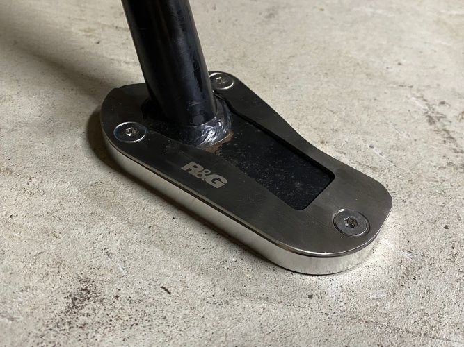

Thanks guys. I decided to try bending it. I actually parked the bike ON the side stand, and used a rubber mallet to flatten it against the cement floor in the garage. Installed the new foot, and it's all good. I'll have to touch up the area where the black paint flaked.
