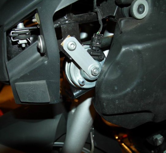

2.While you can see the existing horn looking through the forks from below, you'll really need to remove it from the side, as you're going to remove and discard the silver right-angle bracket currently mounting it. Big long extension on socket wrench is how I did it. Even more reason to remove the painted side panel.

3. Mount the HIGH TONE horn to the same place you removed the existing horn and bracket using same screw. HIGH is molded into the plastic of the new horn and in any event if you mount the low-tone horn here the wiring won't reach. Obviously attach the wiring you've just removed from the former horn.
