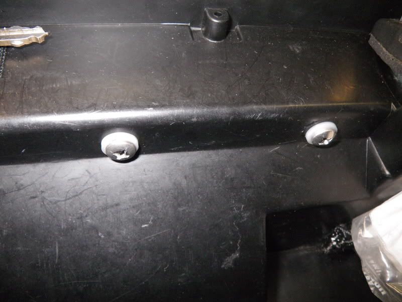

The latch can be removed from the mechanism and can be aluminium welded if you have the broken piece and know a good welder. It is a small part to weld.
It easier to replace the whole mechanism. Either way, the pop rivets must be drilled out and the holes cleaned.
As far as rivets go, I choose to thread the rivet holes 10-32 unf and use 10-32 x 1/2" ss screws instead. The screws are accompanied by a #10 x 1/16 nylon washer for water sealing. You can forgo the nylon washers if you use silicone sealer.
The screws are less than $2 and the latch assembly can be easily removed/serviced anytime
