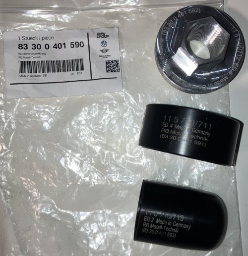

I don't think so. I just checked again, and according to my Clymer manual, the seal's lip has to be formed on one tool and then a second tool is used as a driver to slide the seal off the first tool and onto the crank and then a third tool threads into the crank and pushes the seal into place.
Just to wrap this us, I wound up ordering the tool set from bike-parts-bmw.com, which claims to be an official BMW Motorrad site. The tool set was shipped from Germany and I got it in 4 days.
Got the old seal out using a screw (drilled a hole using a bit with a stop) and installed the new one with the tool.
That’s great!
I would like to see a picture of the tool- if you get a chance.

The total for the tool set came out to around $115 (the breakdown was 70 for the tool and 45 for the shipping). MAX BMW was $90 for the tools, no idea what the shipping would have been, but they quoted me 4 weeks.
