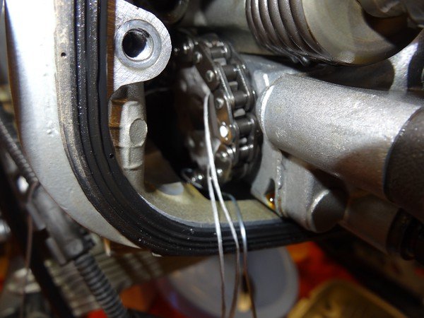

I treated mine to Lennie's Rocket Sprockets plus the AF-XIED. I was quite happy with the bottom end performance boost. The Lennie's cam sprockets are not a difficult install, but it would certainly be possible to muff it up...
