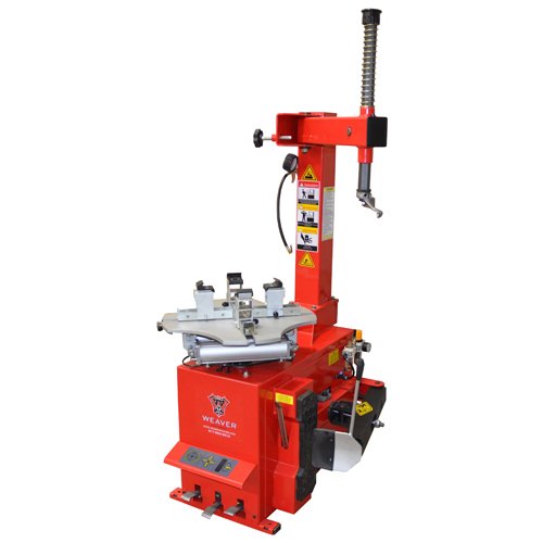

After 10 years of changing my tires with a Harbor Freight changer and asking the wife to help, look what she bought me. I think she was sending a message.

I have long said that if you seem to be the guy that never gets invited to parties, has no friends and no one ever calls, then get a tire changer. Suddenly you will have friends you never met, strangers will appear at your door with tire in hand and your phone will not stop ringing. I imagine that if you have a pneumatic tire changer you will make the Hollywood “A” list.
