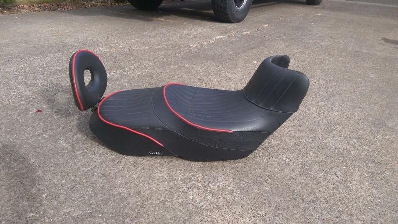

My R1100RS Beta has the standard factory 2-piece adjustable seat. I just scored a one-piece Corbin off a '96 on eBay, and I'd like to know if anyone is familiar with mounting a bench seat like this on a bike that was originally equipped with the 2-piece seat.
I see there are different brackets available for the bench seat on Max BMW, but they are $50 apiece. If I have to I'd rather fabricate something at that rate. Curious if I can mount it using or modifying the existing brackets.
Pics of the seat, and mounted on an RS:

1/4" nylon spacers mounted under the latch mechanism should elevate the latch to the proper height to enable engagement of the hasp. In addition, you might need some longer latch mechanism mounting bolts.

The corbin seat has a great feel, relative to foam density, but sits at a height corresponding to "medium" for the stock seat. It was too low for me.
