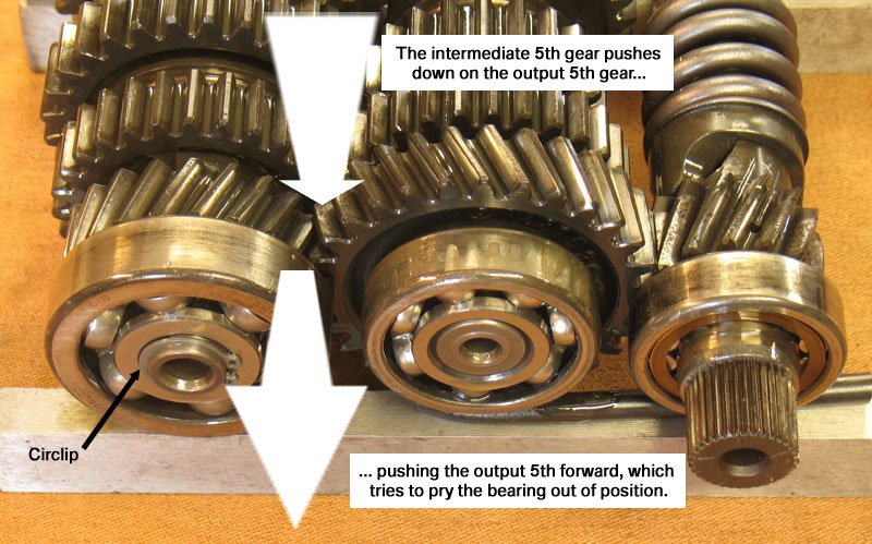

For the 1987 model, you probably would want someone to look into adding the circlip to the front of the output shaft. It was eliminated in the 1985-ish timeframe...returned near the end of production. The bearing has been known to walk off its location and create issues internally. Anton Largiader describes the issue on his website:
If relatively-nearby Matt Parkhouse is not up to doing the work, other alternatives are Friend of the Marque master wrench Tom Cutter (near Trenton, NJ, rubberchickenracinggarage.com), and the also experienced Anton Largiader (Charlottesville, VA, vamotorrad.com). While these options involve shipping, that is an issue which can be overcome. Anton also has a large number of tech articles at largiader.com. Both of these gentlemen are very highly regarded.
And definitely a +++1 on Kurt's suggestion for the "missing circlip" inspection. If it's not there, you should not hesitate to have the shaft removed, have the necessary groove milled in, and have the circlip installed. BMW's removal of this part for a couple years to save a tiny amount of production cost was a huge mistake, as evidenced by the fact that once the problems started showing up in the field they put the circle back into the later airhead transmissions.

Spent a couple of hours with Matt Parkhouse @ his SHOP, disassembled gear box while there. Great experience. As suspected broken spring on shift mechanism and missing circlip.
The circlip modification involves removal of the output shaft, the bearings, and I suspect, the gears on the shaft. The shaft must be "turned" on a lathe and the groove cafefully machined in the proper location. Then the gears and bearings reinstalled on the shaft followed by the circlip. I shipped my output shaft to Boxer2Valve to have the circlip added. B2V took care of removal and reinstallation of the gears and new bearings. Matt may have someone near him that he relies on to do this machine work, but I expect that it is more than an afternoon activity.
If you're set up for it, it's a really fast lathe operation. I don't really charge anything specific for it; if the shaft needs it I just do it.
The bearing had pushed creating space between the bearing and gear. Sent shaft out for turning a circlip groove. Hopefully the cheesy spring last longer than 28k miles this time.
