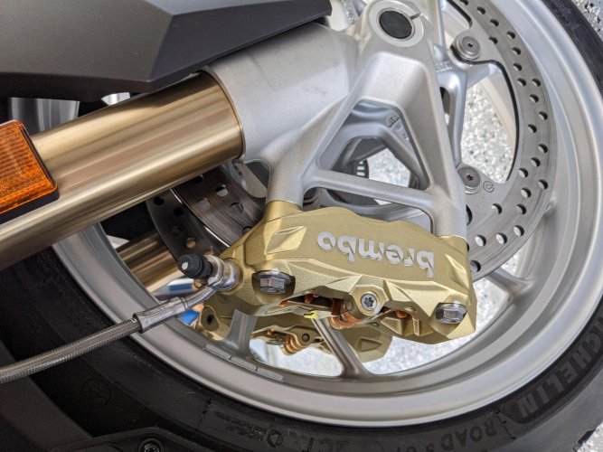

Like this? On my 2020..:heart

They look great, I like the gold too.
Steve
The gold color was standard on my 2020 719 Hayes setup. I believe they all are. Since I converted these myself (At the BMW dealer, of course, for warranty purposes, etc. and since it was on my own nickel, I ordered the gold ones.). According to my DOC (Dealer Of Choice) they will submit the bill for all this ( a little over $ 2,100.00) to BMW, now that the official word is Brembos. We"ll see if they want to participate. Doubtful, but possible.
BTW, I now have about 4K miles on this setup and there is absolutely NO problem of any kind. Since these Brembos are so-called "Monoblocks" they simply cannot leak like the Hayes "clamshell" setup. Now, maybe they could leak from the piston area, but Brembo has been doing this long enough with these same calipers, so they seem to be a pretty solid setup. They are on my 2013 F800GT as standard equipment and have been on almost every BMW model out there.
