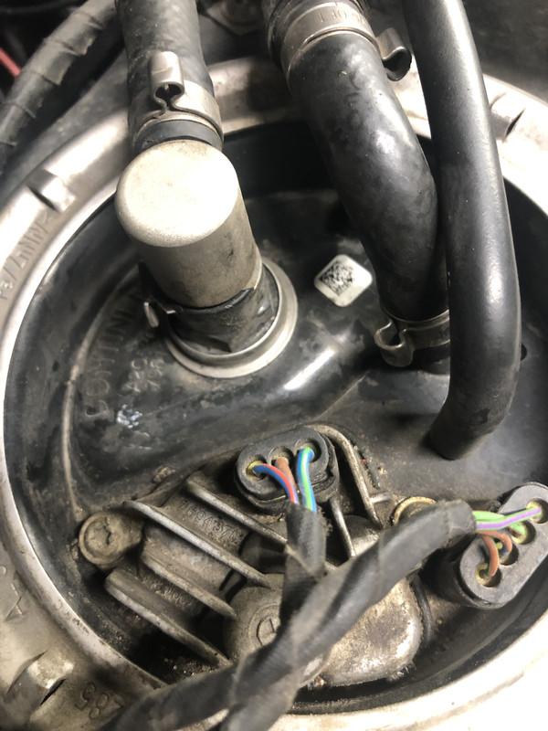

    I have 2 RTs in the garage; an ‘06 and an ‘09.
    I took the 06 in yesterday for inspection under the recall and the tech indicated the fuel pump did not need to be replaced; fuel pump flange was in excellent condition and had not had the (original) recall repair performed on it ...and no cracks of any kind.
    I just dropped off my ‘09 this morning; I KNOW it’s been fitted with the reinforcing ring from the previous recall.
    In speaking with my BMW tech there were apparently two different kinds of rings installed on the fuel pump flange; one had a little flat cut on the edge of it the other did not. Only one of those types according to the recall paperwork will trigger a fuel pump replacement (providing the flange isn’t cracked...which would trigger replacement anyway).
    The quickest way for the tech to inspect it is to pull off the left side panel which only takes a couple of screws or bolts and use a flashlight and an inspection mirror and look at the flange and ring. Here are the two types of rings:
    Waiting for the call this afternoon from the dealer to find out if they will have it for a couple of weeks - which they would if they have to order the replacement fuel pump.

    Quote Originally Posted by rangemaster View Post
    Updated previous post with addtl info and pics
    Which one triggers the recall - with flat or without flat?

    Quote Originally Posted by mikegalbicka View Post
    Per rangemaster's information and pictures, two dealers I have spoken with in the last two weeks confirm, via recent documentation and pictures provided by BMW, the sleeve with the little flat side triggers the recall. The dealer still has to inspect the bike to confirm it. I guess either no sleeve or a previously installed sleeve without the flat side would qualify if a leak exists currently.
    My 2011 RT had the previous fuel pump recall done in 2014, which involved installing a sleeve with the little flat side. That repair shows up with a specific code in the bike's history, and that code indicates which sleeve was installed--the one with the flat side. My dealer pulled up the history and confirmed that the history indicates the flat-sided sleeve was installed, qualifying the bike for the recall. They said they still need to physically inspect the bike, and upon confirmation of the qualifying sleeve they will install a new fuel pump per the recall parameters.
    Last summer I repaired a leaking fuel inlet quick disconnect and took pictures of the repairs, clearly indicating the sleeve with the little flat side, although at the time there was no recall in effect. I showed those pictures to my dealer last week and they said they still need to inspect the bike before proceeding with the recall. I will have that inspection done late this week and then they should be able to complete the recall repairs.
    It sounds like the dealers finally have some finite direction and documentation in hand from BMW on how to address this recall, things I found missing in my earlier inquiries about having my bike fixed. Hopefully now everyone is on the same page.
