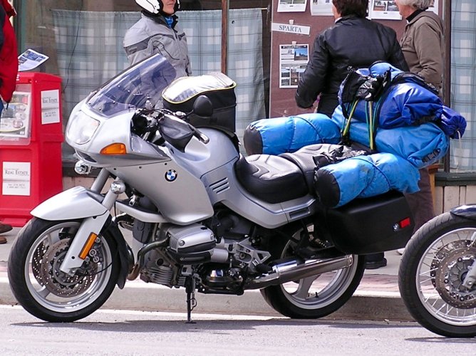

Once you figure things out, no problem with gear storage. What others have said with the RT rack (bigger than the standard RS rack), standard BMW bags. I'm not a fan of a hard trunk as it limits loading options on the rack. Bungie buddies on top of the bags allow sleeping bags and pads to be packed on top of bags. BMW tank bag for smaller, lighter items. Under the seats, tire repair kit, spare headlamp bulb and spare alternater belt. In the way back under the seat, a set of spare bulbs and fuses for all lights on the bike as well as additional tools with stock tools. When traveling two up, you just learn how to be efficient with space, and over time you find compact gear.
Two up and with two weeks worth of gear including camping gear and camp chairs. We've since acquired compact sleeping pads and chairs so traveling now with much less than in the photo.
Traveling solo.
