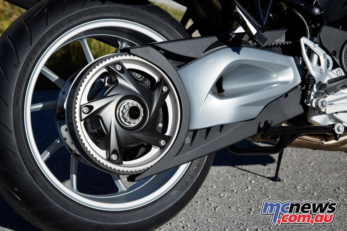

I put 23K miles on a '13 F800GT with its elegant belt FD. It was quiet, reliable, clean & more efficient than shaft driven designs. Besides looking kind of cool I find the fact the front & rear sprockets (as w/ chains) are all turning in the same plane as the crankshaft is just a very good thing compared to splines, u-joints and 90 degree changes of direction to just be the picture of inelegance and clunkines, and indeed my '16 RT does clunk here and there! I loved the ZERO maintanence for the belt drive. Plus one gets a warning when the belt is beginning to give up the ghost as you will see hairline cracks in the some of the teeth in the belt if you look now and again. I think the risk of a hard rear-wheel lock up due to a catastophic failure is greater in shafts than belts. They aren't great for off-road but my dream replacement for my RT as I age, besides losing 100lbs, would indeed be incorporating a belt drive, and to lose 100lbs and be 100% capable as a Sport Tourer w/ full on tech, performance AND comfort you would need the belt to help meet weight and power concerns.
I do like the belt for a street ridden bike. My wife's F800ST has been the least dramatic final drive system I've ever maintained. In 12 years it has demanded nothing in the way of repair or maintenance other than a quick check at service intervals.
For me it has been eight (8) years this month, but the result is the same.

I like belt drive for road bikes. But go very cautiously on gravel roads! :whistle F800ST/GT change belts about 40K to 50K.
