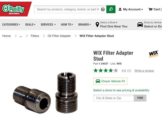

    Looks like many filter studs are common size. Donít know if this one fits, though :
    https://www.amazon.com/WIX-Filters-2.../dp/B000C9XYQG
