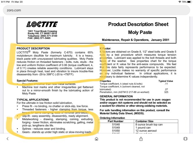

    CEA551D4-8F39-48FD-BF69-8B7F01DFFFD2.jpgHas anyone tried using loctite LB8012 moly paste to lubricate spline shafts?
    Spec sheet shows 60% moly.

    I've been using it anywhere BMW calls for Optimoly TA since 2011. It's also labelled as Loctite 51048. My label claims 65% moly.
