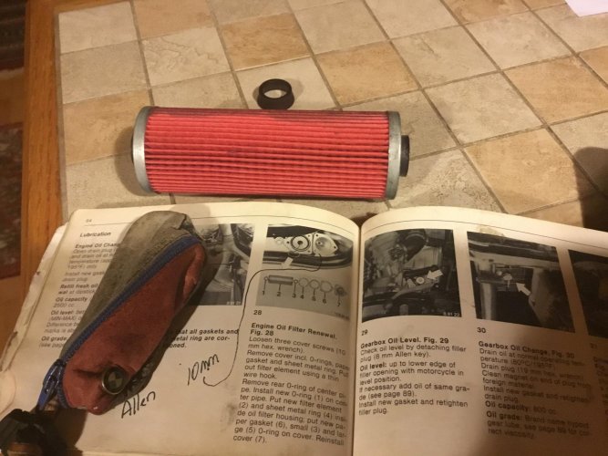

I’m about to install a K&N oil filter in my ‘81 R65. I removed a hinged filter and a black o-ring was on the center pipe at the rear. I removed that as well. Do I replace that or is it not needed with this filter? I will attempt to include a photo showing the new filter with black rubber extensions at both ends and the rear center pipe o-View attachment 75896

The R65 is a bit of an odd-duck, so not totally sure. But on my '78 R100/7, I use OEM filters and have had good luck with the hinged filters. These filters come with black O-rings already on the filter, so no additional O-rings are needed. Not familiar with the K&N brand of filters. But I suspect no additional O-rings are needed. Measure the hinged filter with O-rings installed on each end. Measure the same thing with the K&N brand. The length should be the same.

If the oil filter is not the same length, is the "gasket dance" the same for an R65 as it is for the other airheads?
I've not heard of any "gasket dance" for any Airhead filter system. Nominally there are large black O-rings on either end. However, there are metal shims and gaskets associated with the cover which is designed to provide the right amount of compression to the large white o-ring to ensure proper sealing of the white o-ring. It's important to measure the depth of the oil filter canister...this distance, nominally 3-3.5mm, sets up what stack-up shims/gaskets are needed.

Thanks for the replies. I wouldn’t be likely to recommend the K&N (made in China) filter. I bought it through Rezvilla, with whom I like dealing. Their information on the filter indicated that it comes with washers/gaskets/o-rings. It did not. This bike is new to me, but I did have some of the necessary o-rings and all from years ago. Guess I’ll get the BMW filter kit in the future. I didn’t end up using the black 0-ring on the back end as it seemed to be redundant. Also, the one that I found on there held the filter element out too far. It should have been removed previously.

In the really old days, oil filters did not come with the o-ring attached to them. Therefore, one installed a separate o-ring on the center tube and probably only replaced them occasionally.
Then, in the 1980s, the filters began arriving with the (square section) o-rings attached/glued to them. For the first time, then, one would use some sort of hook tool to remove the o-ring from the tube and then on just install the the new style filter. Much more convenient.
If your bike still has an o-ring on the center tube, remove and discard it. The o-ring attached to the new filter is all you need.

This directly answers my question. Thanks!
