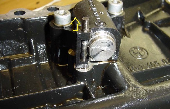

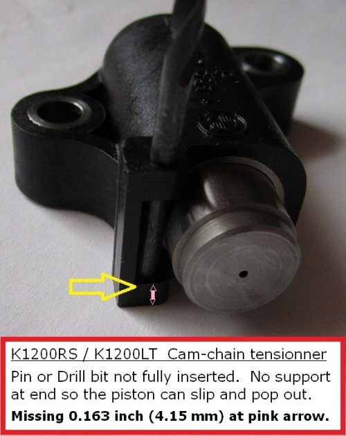

You are not the first one to struggle with the cam-chain tensioner to get enough slack. The K1200 "brick-engine" tensioner design is different than previous "brick-engines" like K100-K75-K1100.
ON the "now closed" I-BMW.com forum and also on other K1200 forums, this struggle has been posted many times during last 15 years. Although, in general most will check clearance BUT will let the dealer do the hard job when/if any buckets need to be replaced.

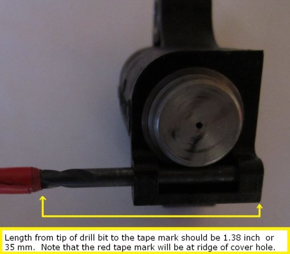

1) 1st common issue is that some have not used a 1/8 inch pin or drill bit. Based on your description above you seem OK on this.
2) the slack need to be taken out from top, so as to allow all chain slack to be at bottom before you try to insert the pin ( or drill bit). This is often done by gently using a 19mm wrench on top camshaft , turning clockwise view from front of engine. Then repeat same for lower camshaft so chain does not bundle up in between both camshafts.
3) the 3rd issue is not seeing from the outside how far you need to insert this pin / drill-bit. If you are not at least 35 mm inside (1.38 inch) then the pin can move sideway a bit , and the tensioner piston will slip thru (see 1st and 2nd photos attached)
Because the tensioner assy is attached to cover (unlike previous "brick") you are allowed to insert pin deeper than length specified above. This design will allow at least 1/4 inch (6 mm) further until the pin hit the crankcase / cylinder wall behind. So you should take advantage of this fact to make sure you are deep enough (see last photo)
4) finally, do NOT remove or loosen the camshafts sprockets before you are sure the tensioner is really locked down -AND- the pistons are all at 90 BTDC (middle of travel from top to bottom of stroke). CLYMER manual gives you a good hint at what to look (for camshafts position) without having to remove the spark-plugs to check 90 BTDC (not recommended to remove spark-plugs for carbon drop outs as specified in BMW shop manual for most "bricks").

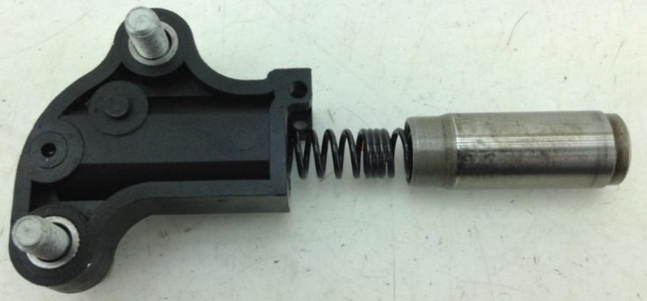

5) When working on pushing the tensioner and lower guide down, keep in mind there is a fairly good spring under this piston. Futhermore, if bike has not been parked for many days after a ride, there is still some remaining oil pressure under piston. See last attached photo...

3). This is the gist of it. If I’d known your guidance about how deep the pin should go, minimum, I’d have realized I didn’t have it seated and would have continued to fiddle with it before removing the cam sprockets.

It’s not clear to me at all how that piston actually gets retracted against the spring force, which as your picture shows, is fairly substantial. Certainly, inserting the pin doesn’t, by itself, depress the piston. This is something I still don't get; maybe the other forum thread will have details.

2) About this question "It’s not clear to me at all how that piston actually gets retracted against the spring force"
re-reading my last post, I realize my mistake in one section - let me correct what I wrote and also clarify further:
- the part about using 19 mm wrench on both camshaft should have said "turning counter clockwise as view from front". What you are attempting to do is to tighten the bottom part of the cam chain without jamming it between the 2 camshafts. By going slowly (about 3 or 4 times) from lower camshafts to upper camshaft, you are sending some of the "looseness" of the chain in the upper part of the chain (between inlet cam and crankshaft sprocket).
- the above 19mm wrench movements will tighten the lower part of the chain and push the lower guide / rail down. This lower rail will in turn push down on piston - as the top of the tensioner piston is touching the lower part of this rail at YELLOW arrow in my photo. CLYMER has photo of this (with cover removed), but I have attached one just in case to make my point clear.
- In some difficult cases, you can also try to push down on lower guide / rail using a long thin tool / screwdriver just as you attempt to push your drill bit into tensioner (follow RED arrow in photo). HOWEVER, with timing cover in place there is very little room to work in this area and if you slip you could damage either (1) plastic guide or (2) one link of the chain. So this technique is not as safe as the long process of turning both camshafts slowly to get the lower part of chain tight.
