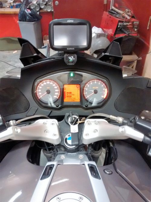

    You can also forget about them and install a third party TPMS
    My 07 doesn't have TPMS so I installed this one by steelmate.
    It uses regular batteries than can be replaced.
    YMMV
