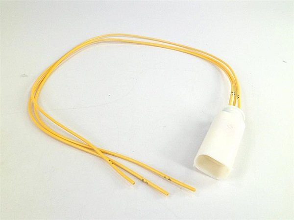

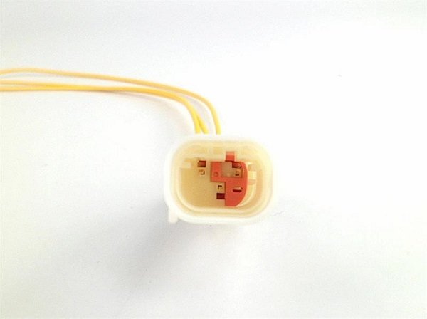

    Repair Plug part # 83 30 0 413 585
    From the parts fiche.
    Function: 3-pin for LED of anti-theft alarm, optional-accessories plug (device end). Can-bus plug that allows you to splice to a GPS power cord and connect to switched power on your Can-bus model. Middle not used, RH wire is power, LH wire is ground.
    You only use 2 of the yellow wires.

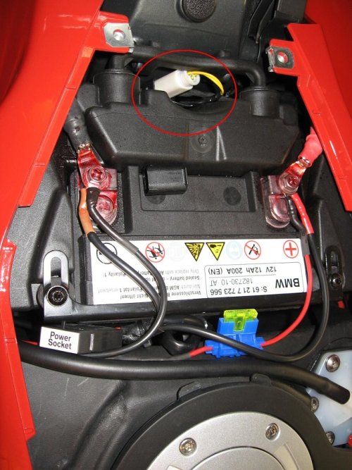

    Picture of K1300S

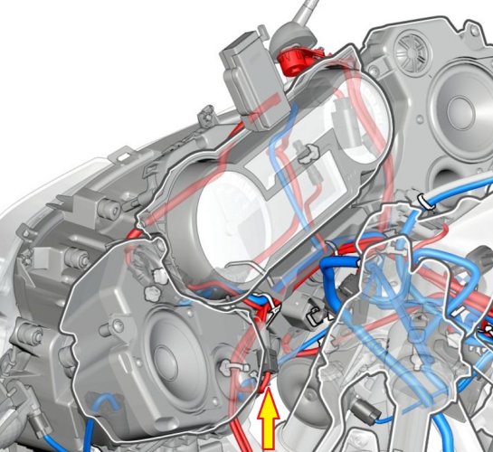

    If your bike (like most dealer-ordered bikes) has the GPS prep package, the connector will not have a cap, just follow the wiring from the mount.
    Hex and Cam heads had the unused plug capped and taped on the right side of the steering head, but I think it was moved to the left side for the Wetheads.
    Somewhere, I recall seeing a sketch showing the plug under the dash, behind the headlight, to the left of the steering head - but I can't find that image right now.
    This one (from the repair DVD) is close, but it does not identify the electrical components the way I remember. Take a look at the wires at the indicated connector, the GPS connector should have a Brown(ground) wire on Pin 1, Red/White(switched +12v) on Pin 3, and possibly a Blue/Green wire on Pin 2.
    Please report back if this helps locate the connector. The question comes up often, but I don't recall seeing a definite answer for the RTW.
