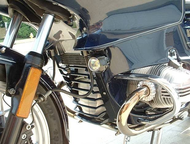

I mounted my "generic" lights under the lip of the fairing. It depends on the size of the lights and base if they will fit.

Did you slip a thin piece of metal between the upper and lower parts of the fairing, and then had a hole drilled in the exposed plate to mount the lights? Seems like a decent way to go.
No plate, they are mounted to the fairing itself. The base of these cheap lights fit under there perfectly.
