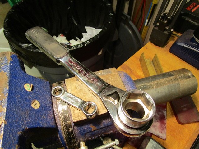

Airheads also need a thinwall 27MM socket to lock the swingarm pivot pins.
I bought an extra 27MM socket and simply beveled the edges with a grinder to fit and also mark the pin after torque to insure it doesn't move.
I also try to balance frame to swingarm spacing on each side when reinstalling the pivot pins.
