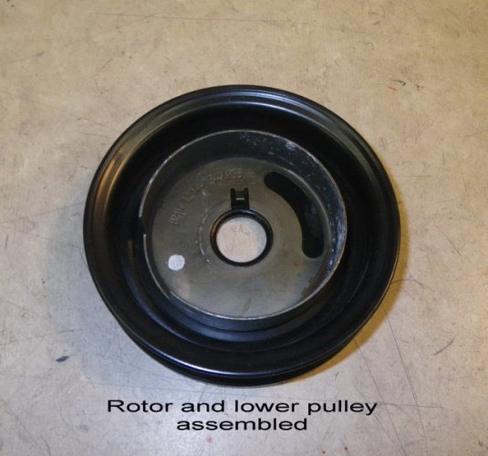

Not having any luck finding a helper in the anonymous book under Maryland area,just want a bmw guy on hand when I set tdc on bike and mark hes sensor before pulling off,.
