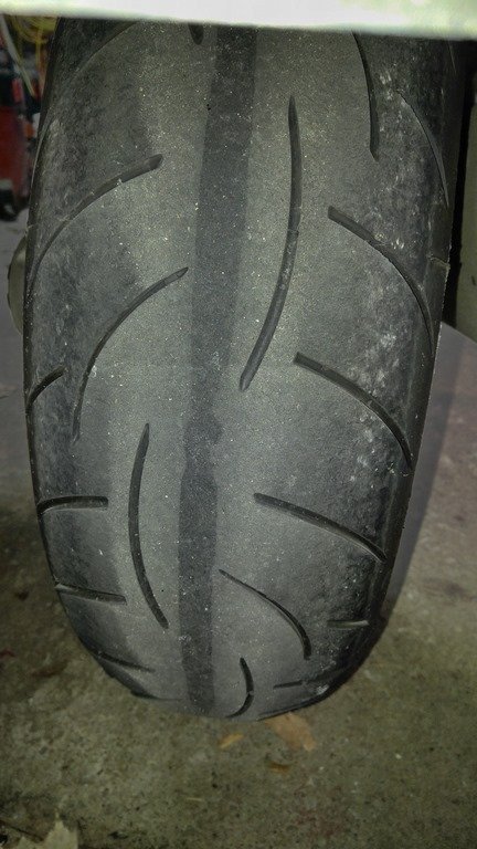

This is what a worn Metzeler Z8 looks like after 5,000 km of superslabbing. I got about 9000 km in total out of those Z8.
The dark band is the wear indicator and you have about 1000 km left before the cords start showing.
If the band showed at 5,000 Km, how did you get 9,000 Km out of it?

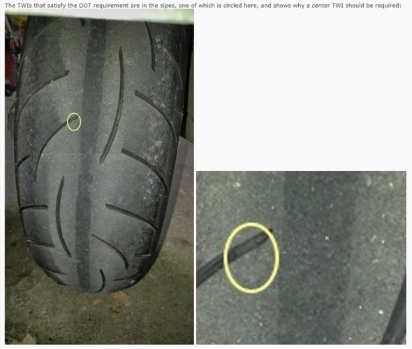

While I agree that the dark stripe is certainly an indicator of wear, I don't think Metzeler really intended it as a tread wear indicator. It's the compound that encases the belts and serves as a foundation for the tread layers. It appears after the tread compound is worn through. Maybe it should made of red rubber?
The TWIs that satisfy the DOT requirement are in the sipes, one of which is circled here, and shows why a center TWI should be required:

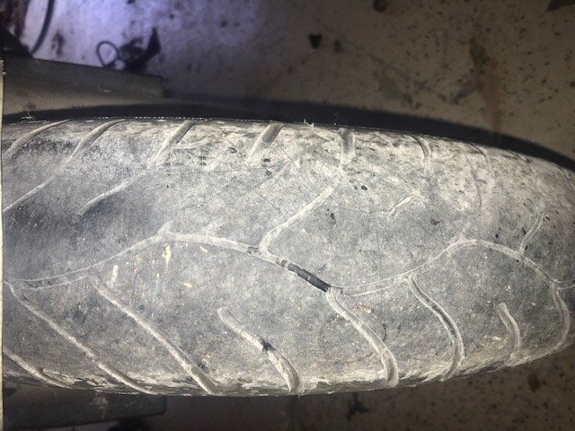

The general location of the legally required indicators is marked as "TWI" in several places on the edge of the tread, much like this Roadtec 01:

I see two things in this picture from lkraus.
First, from the TWI that is circled, it seems like there's more tread left. You could possibly get away with a full day of riding, depending on the roads.
Second, that center dark stripe of the center one inch, says you have enough tread to possibly make it to the dealership for a new tire.
I got 4K Km in then 5K Km of slab... That is when the band started showing.
