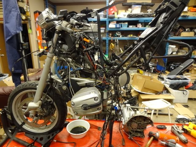

I have an 04 R115R Rockster with 35k miles, in mint condition, no problems. As a winter project and before disaster strikes I decided to replace the clutch plate with the modified (longer spline) plate and lube the input shaft splines. I am most of the way into the disassembly process. I'm at the point where Mr Clymer tells me to remove the swing arm from the gearbox. I'm not sure I want to do this and I'm not sure whether it is necessary to do so. Why not just pull it all apart? Because (i) I'm lazy, (ii) I don't like pulling stuff apart that ain't broke, since I am prone to breaking things in the process. So, questions...
Can the gearbox and swingarm be removed as a unit? Pros and cons?

Both gearbox and FD can be removed together. I do it 50% of the time.
The only reason to disassemble is inspection or seal replacement.
Helps if you have a helper on the other side to support the weight and be careful to pull back straight so the pushrod does not get bent.
2 guide pins on the engine block help during the re&re

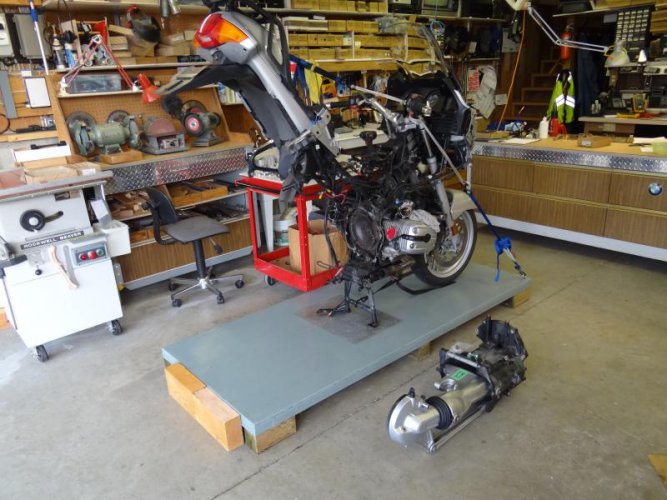

There is no need to separate the swingarm from the tranny. I have removed a tranny even with the wheel attached. And with just the final drive attached. And with just the swingarm attached. I prefer the latter because of weight and balance issues. Otherwise it all wants to flop over to one side. But just the swingarm and driveshaft is no bit deal, and is the normal way I do it.

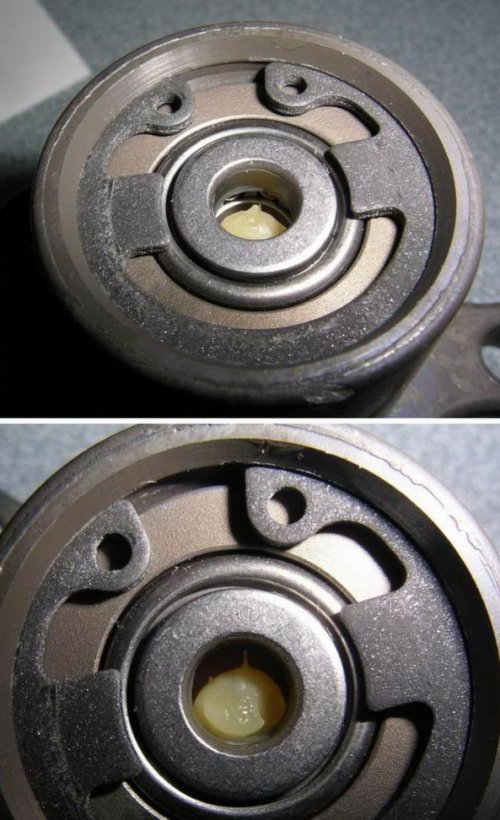

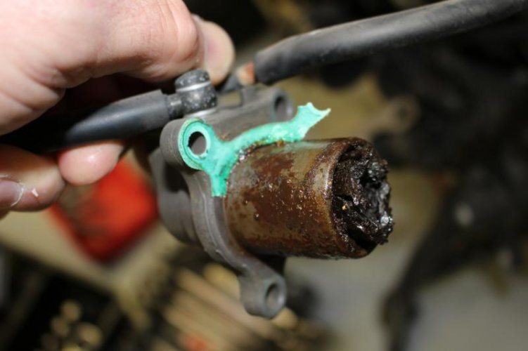

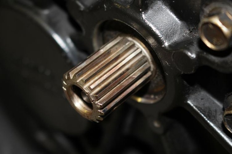

Thanks for all the advice guys. I now have the gearbox out. The input shaft splines @ 35k miles look great to me (photo). The old Clutch disk splines look good too but of course I will replace with a new modified disk. The only issue I have seen so far is that there was a mess of oily gunk on the end of the clutch slave cylinder that pushes against the clutch release pushrod (photo). Is that normal? The slave cylinder itself does not appear to be leaking. IMG_3422.jpg
Thanks for all the advice guys. I now have the gearbox out. The input shaft splines @ 35k miles look great to me (photo). The old Clutch disk splines look good too but of course I will replace with a new modified disk. The only issue I have seen so far is that there was a mess of oily gunk on the end of the clutch slave cylinder that pushes against the clutch release pushrod (photo). Is that normal? The slave cylinder itself does not appear to be leaking. View attachment 65281
If the gunk is water soluble then it is brake fluid and bearing is failing. (the piston starts to spin in the bore scoring it) New slave needed.
When you get the new slave be sure to add grease to the bearing.
Picture below shows undergreasing.

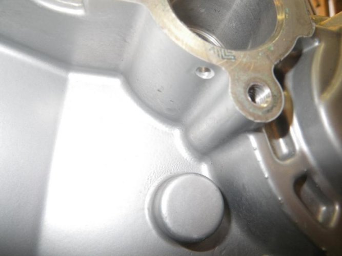

Also wise to drill a hole in the bottom of the housing to allow fluid to escape instead of migrating along the pushrod and contaminating the clutch disc.

Also wise to cut back the sheath to avoid rusting of the fitting. It fills with water from above and eventually rusts out the fitting.

Thanks GS Addict... the top clutch line already shows corrosion, confirming your warning to trim back the plastic cover on the line to let moisture out.

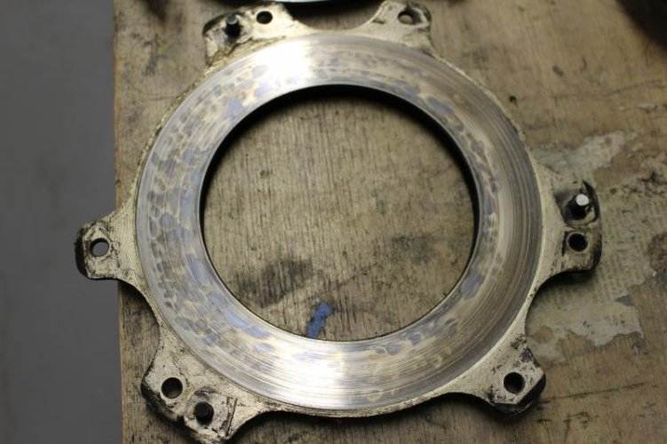

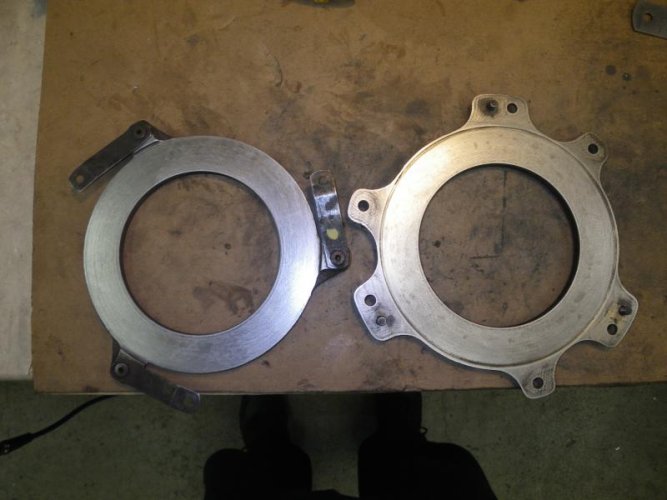

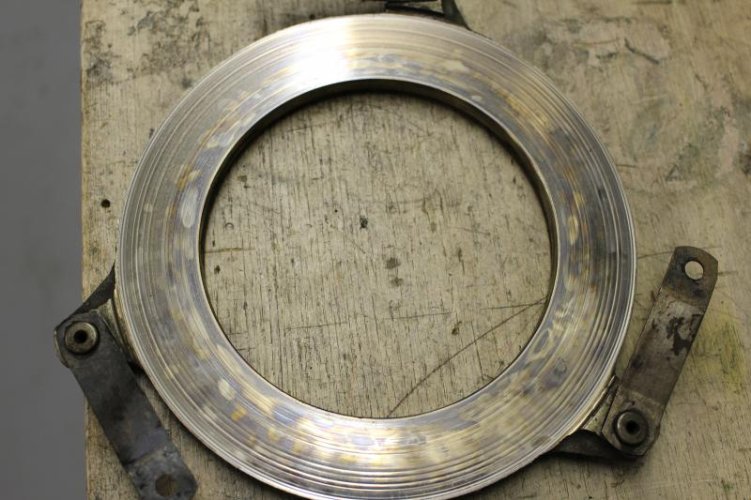

Next question - what do you think of the state of the pressure plate and housing cover (photos below). They show some discoloration and some grooves. If these were brake disks I'd say "no problem" but I don't know how sensitive clutches are to imperfections and wear. Can/should these be resurfaced?
I levered up the back of the battery box. It worked to get the gearbox out, which is just as well because if I had to remove the ABS unit I would be fixin to kill somebody. Let's see if everything goes back in the same way.. not feeling too optimistic about that.
If you have to wrestle with the back of that tray, the ground strap and are having difficulty with engaging the splines all at the same time you will definately be fixin to kill somebody.... probably yourself (grin).
Take a straightedge to the surfaces. Are they flat?
If not, putting in a new disc may cause slippage as full contact is not available.
If they are flat, take an orbital sander with 120 grit emery paper and rough up the surface before reusing
These ones cleaned up nicely last week

Update: the motorcycle back together and survived a 50 mile test ride with no issues. While the bike was apart I replaced the entire clutch pack including the longer splined clutch friction plate, rebuilt the clutch slave cylinder, checked/adjusted valve clearances, replaced the alternator belt, replaced the spark plugs and did a full ABS servo system bleed. Total cost was around $450. The bike now feels just like it did before I pulled it apart, which I view as a positive sign. It was nice to see that, at 35k miles, all the innards were in great shape (including the original clutch and splines) and within spec. The only part that really needed repair was the clutch slave cylinder although it was working fine before hand.

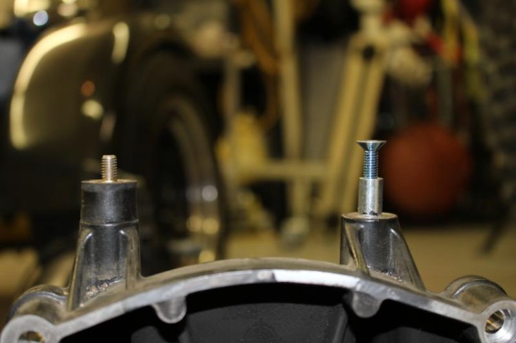

Regarding the battery tray stud clearance issue discussed above, I did a mod so that I would not have to lever up the tray to clear the wiring harness should I need to pull the transmission again (I did not like bending everything out of the way - seems like it is asking for trouble). I removed the left rubber mount from the gearbox and replaced it with an M6 screw and a 1/4 inch steel sleeve cut to length - see photo below. Next time I will remove the screw from above and the sleeve will drop out of the way so the trans can move back without fouling the wiring. Installation was easy in reverse. If I had more time I would have worked out something with a rubber bushing instead of steel but steel should work.
