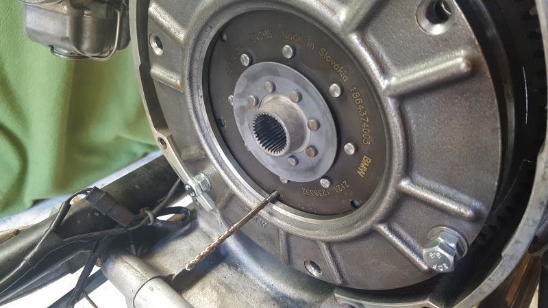

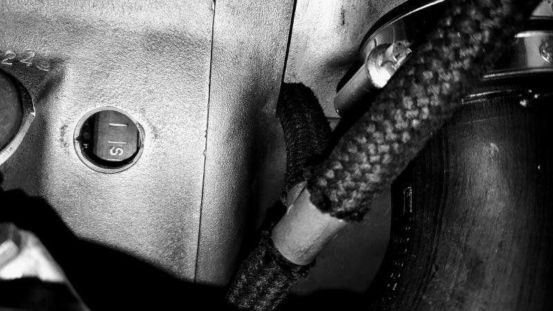

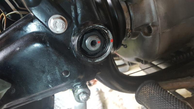

    I appear to be stuck on the timing. Here is where I'm at -
    new points and condenser from Max BMW. They don't seem to be the problematic type with the long can block, but I can't seem to get the static timing anywhere close. I've tried adjusting the gap from .004" to .020". I've also rotated the points plate to the extremes of the slots. And no matter what I do the transition from closed to open is probably 20 to 30 degrees before I see the "S" in the timing hole.
    Pics may help...
    With the "S" visible in the timing window the pink dot on the mechanical advance is in the position shown (use the red dot on the case as a reference point):
    But here is where the closed to open transition occurs with the gap all the way down to .004" and the points plate rotated fully CW:
    And it only gets worse with a larger gap and the points plate rotated CCW. There isn't even enough room to open the slots in the points plate to correct it. What am I missing?

    The point gap is set with the points rubbing block riding on the highest part of the advance cam. There is a tool available from Cycleworks that replaces the advance unit which allows for setting the gap without having to work around the arms of the advance unit.
    It does look like your points are not the offending one. Here's something that compares the two side by side:
    https://forums.bmwmoa.org/showthread...l=1#post885249

    So after a bit more research and some helpful suggestions I've traced the problem to the flywheel - it was reassembled by someone one bolt hole off from the correct orientation.
    I'm in the process of correcting that and then I should be good to go. Thanks again for all the help.

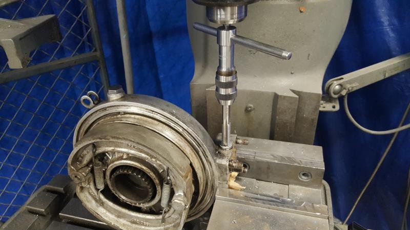

    Right now I'm waiting to get back to work so I can modify my 27mm socket to fit into the swingarm. I'm going slow and keeping things organized.

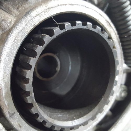

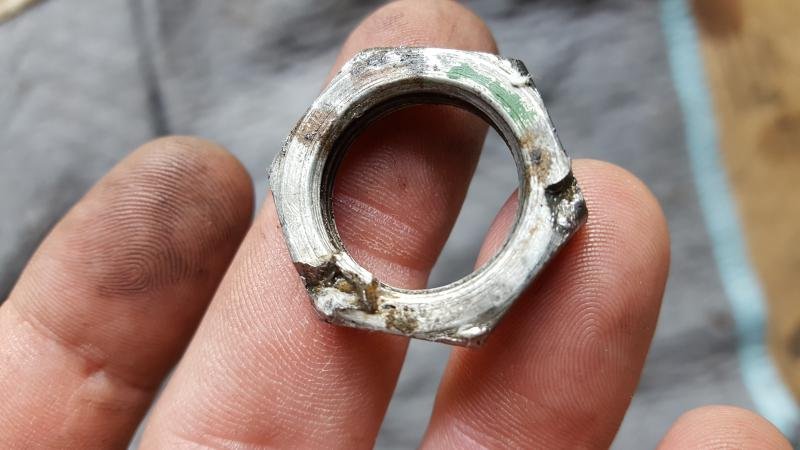

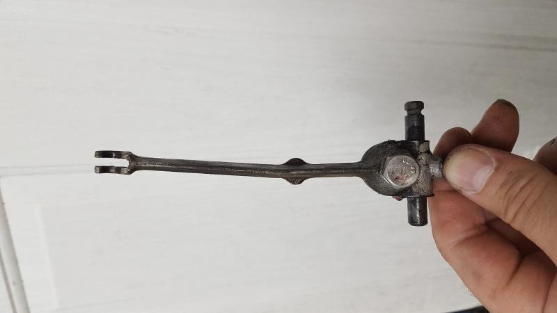

    My tools came in and I got to it, but as expected I found a few more things that needed attention:
    Axle nut with some hefty chisel marks in it:
    Bent clutch release lever - though this may have been done to allow for more clearance near the frame, I need to look into it a bit more.

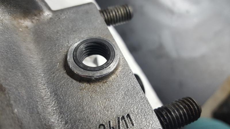

    Stripped final drive filler hole:
