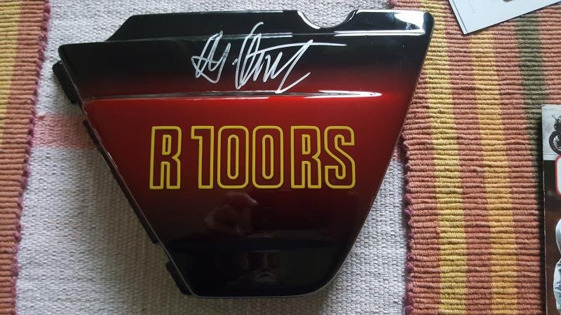

Thank you. I rode Gonzo Sunday to a restaurant for our Colorado ABC annual planning meeting. A fellow crossed the street as I was parking wanting to know more about my "really unique looking bike."
At many gas stops on the ride to PA and back, someone would come up to ask me about the bike and comment about how it looked, "... not like the ones you see every where these days".
Hans' statement still speaks to people.
