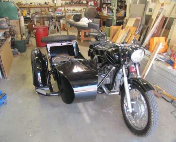

    Ended up buying a '63 Dnepr fitted with '06 Ural engine, gearbox, driveshaft, and final drive.

    I have no way of knowing, for sure, other than what the seller told me, but he said he bought a Herzog trans from IMWA. It shifts up and down well, but I'm having trouble getting it out of reverse. Sometimes it won't even go into reverse unless I shut the engine down and bump the machine back and forth a bit. Not too comforting at this point. While the speedo (replaced) indicate 11000 K, he told me the transmission only has about 500 klics on it. Could be it njsut needs to be beaten... ahh... broken in.
    Doesn't seem to be too much feedback on my post from the Tovarishchi over at Soviet Steeds...
    I'll post some pics shortly.

    I've logged about two hundred miles so far. Some issues to sort out. The first one was almost two inches of toe-OUT; that remedied most of the wobble and pull to the right.
    The sticky wicket right now is a noise that sounds like tire-rubbing-on-fender in right turns.

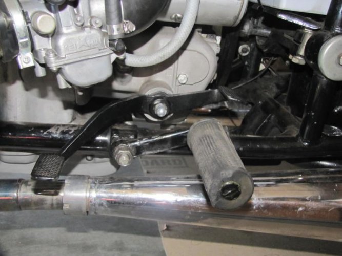

    The "clocking" of the toe/heel shifter is problematic. I'm tall and have to perch on the back of the saddle so using my heel is difficult. I may have it rotated too far down (the toe end).
