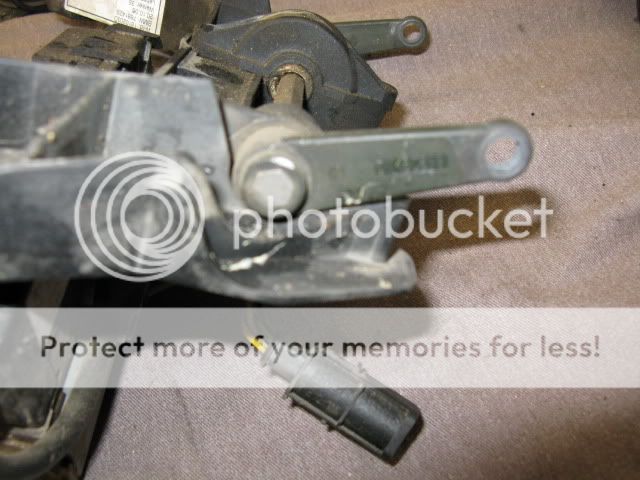

    It's not a hard job,,,,
    1,,Remove upper side panels
    2,,remove windshield
    3 pull pins (4) to remove bracket that windshield bolts to,,
    5 pull off rear view mirrors
    6 remove interment cluster cowling
    7 Unplug head light and turn signals
    8 Run windshield motor to down position
    9 remove head light assembly (4 bolts with big washers as seen in pix)
    10 Remove windshield motor assembly (8 torx )
    Now you have the motor assembly on the work bench
    11, I use the face of the cut off wheel to clean up the ends of the hex shaft ( You could also use a dremel tool or file to do this,(,I think BMW pressed the ends of the hex shaft to keep the arms on,)
    12,Tap the hex rod through with a small hammer and punch
    13,,clean up hex rod with a little emery cloth and Install new arms and tighten down allen's ......
    14 put in all back together and ride,,,

    Lower Arm Removal
    The arms on my 2006RT have circlips holding them on. After removing the circlips, I used a screwdriver to pry the arms from the shaft. It did not take a lot of pressure to remove them. Apparently. BMW used different methods to secure the arms over the years.
    Prying the arm off
    Don't take life too seriously, You won't get out alive!

    Great information. I'm a newbie with a broken upper arm, but plan to replace both sets of arms on my 2006 RT. Two questions:
    1. Is it really necessary to remove the windshield motor assembly? The hex shaft seems completely accessible while still attached to the bike.
    2. Re: the ends of the hex shaft being "pressed" to keep the arms on and cleaning up the ends with a file...If the ends of the shaft are already clean, should the arms be easily pried off or does pressed mean that a little bit of metal must be filed off each of the six faces of the hex shaft, on the outside of the arms, to enable the arms to slide off the shaft? I'm leery about forcing anything. How about WD-40?
