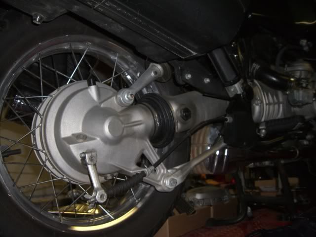

    This is a crappy pic of an airhead paralever -- note the torque arm under the swingarm (where it was always located until the wedge K12's came along), and the pivot pins connecting the final drive to the swingarm at the side of the rear end of the swingarm (the rod above the swingarm is the lower end of the shock absorber, which is generally oriented in the same place as on the monolever):
    As far as other advantages/disadvantages, two universal joints in the paralever vs. only one in the monolever. The paralever GS universals have a poor reputation for longevity, apparently due to the more extreme angles the swingarm moves through than the other paralever bikes. I'm sure others will pipe in with more thoughts from there.

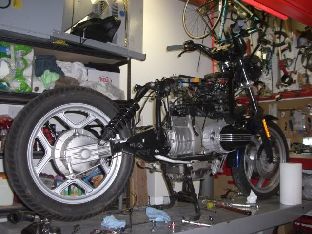

    Is that an R80/7 on the lift?
    Nope (the monolever is a clue it's later than the /7's; also, the black valve covers are a clue it's not an R80/7 -- the R80/7's had the same shape valve covers, but were not painted black).

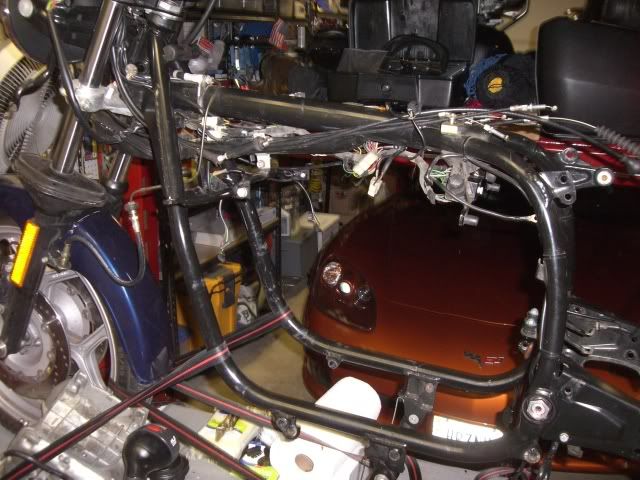

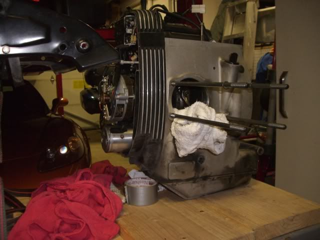

    It's my new-to-me 1988 R100RT in the process of being stripped down for a going-through to sort out a number of issues and to prep for dual plugging. Engine is out; forks & steering head have come out for head bearing replacement and have already been reinstalled.
