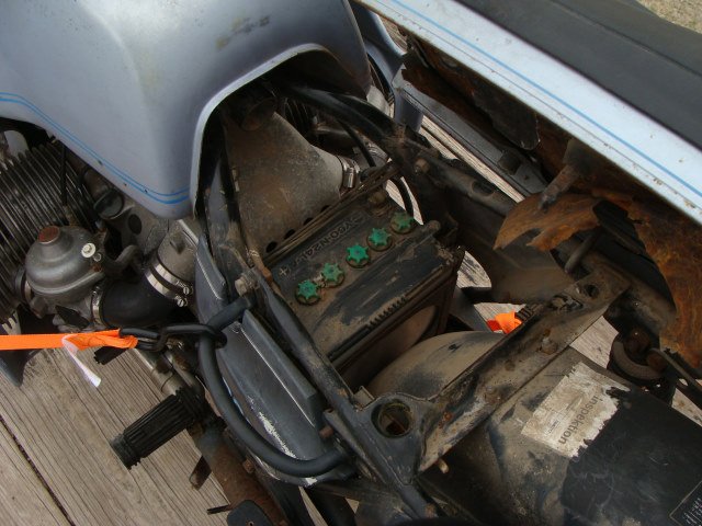

My thanks to all / plenty to read and comprehend ! My frame no. is 6180215, in 11/76. I sent my info to the RS web page guy to "register". Here's a scary story - the fella that sold it to me stated that he had put a charger on the battery and that all the lights worked. Well, see the pic - the battery is over 20 years old. Sheesh. Whew !

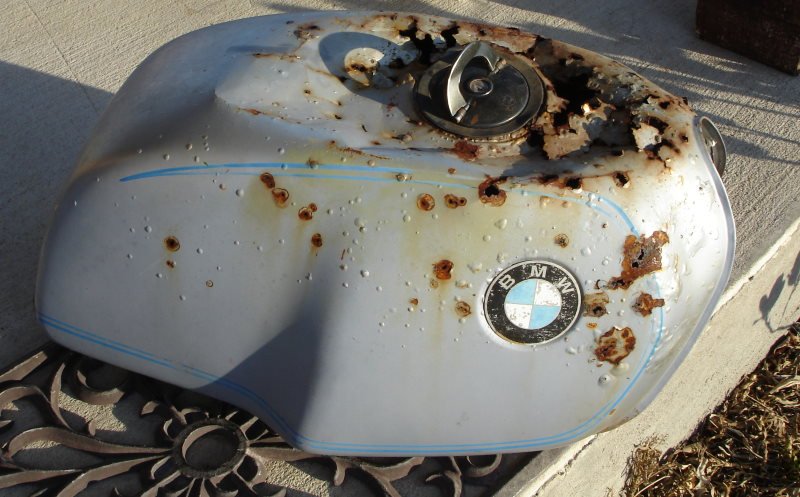

RS Fuel Tank
Consequences of storing a motorcycle for 20 years with fuel in the tank.
I suspect this will not be readily repairable. Nice pinstriping, though. / Ron
...I suspect this will not be readily repairable. Nice pinstriping, though.
You might wish to check out this shop for repairs to your fuel tank.
http://www.gas-tank.com/bike.htm
You might also wish to check for prices for a used fuel tank (for a /7) from folks that carry used BMW parts -
http://www.bobsbmw.com/
http://www.re-psycle.com/
http://www.airheadsalvage.com/
and of course ebay.
BMW thinks pretty highly of their fuel tanks. A "new" fuel tank for your RS is
part #16111452283 ; description= fuel tank prime coated ; price = $1,120.68
And you still have to have the tank painted and pinstriped!
Fuel Tanks
Thanks for the info & links, Robsmoto - I think used is a good idea...I would not trust repairing this one !

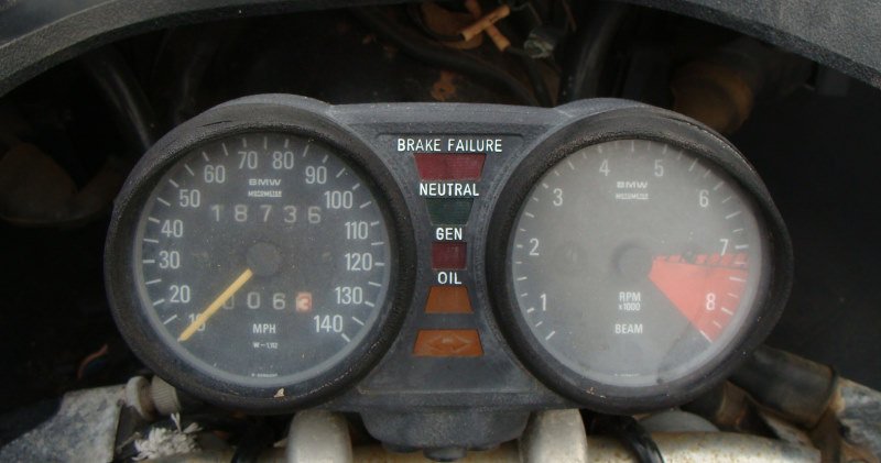

18k or 118k ?
I dunno, man. A lot of what I see says "118k", not 18k. If it's only 18k, where's the original windshield? :scratch
Good question. I believe it to be 18k miles for several reasons - it is a local bike, and the owner had 5 BMWs, maybe 4. I have seen his 1970 R75 and his 1965 R60, complete with sidecar. I have seen his R1100RT, and I bought the R100RS. All of this was in his son's garage, as the owner is hospitalized, sadly, and incapacitated and his son is working off Power of Attorney. The owner was a big bike mod guy - my RS has Koni shocks, and the cross over pipe is missing, the ports welded closed.
I just talked with the sellerand he thinks it is only 18k miles. Am looking for more records / data, and I know the local servicing dealer, so I can check there for service records.
We shall see !
Thanks, Ron :dunno

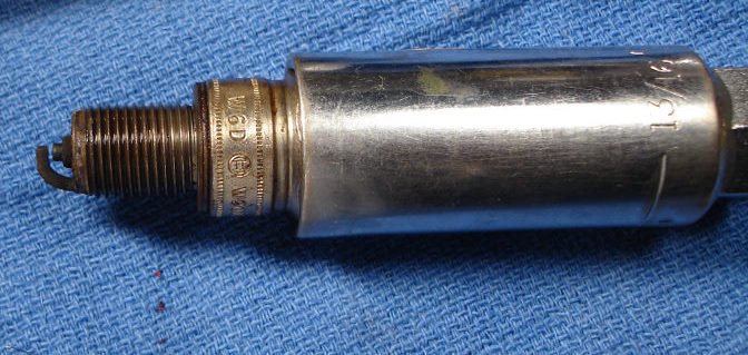

Well, the left spark plug gave in to the penerating oil, but the right is still fighting me. It turns just a bit but is very tight. I am soaking it periodically, heating with two heat lamps, and occasionally I go out to the shop and take another quarter turn CCW or so. I have no idea of how to tell if bad things are happening.

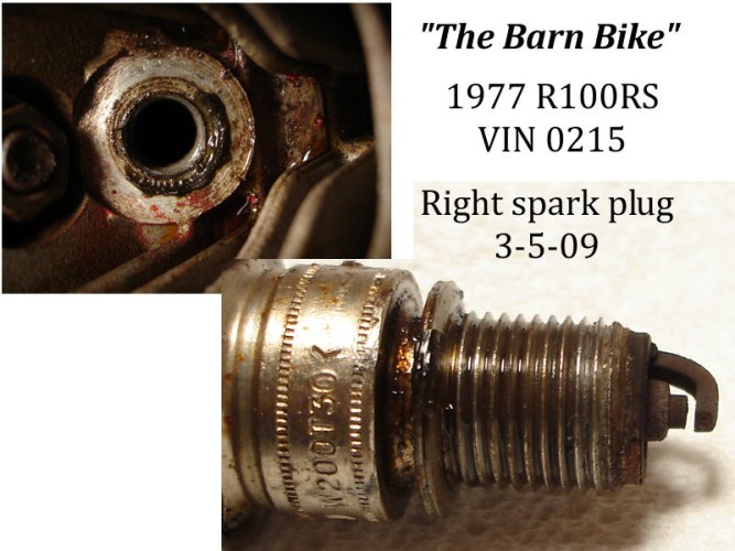

Right plus is out
Well, yay, the right (starboard for the Marines / Navy in the crowd) sparkplug is out - pen oil and heat lamps and lots of time. The threads in the head, from what little I can see, and the threads on the plug, do not look nearly as bunged up as I expected. Likely can be cleaned up, just guessing. Looks like some type of rubbery black stuff was around the base of the plug - Permatex ? So OK, both plugs are out, and my Kroil is "supposed" to be delivered today.
Cheers / Ron
