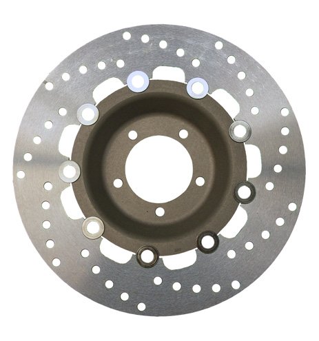

I think that the EBC just bolts on.
I have had good report about them, they wear less because they are drilled/slotted properly, they are "floating" to compensate for heat growth, ...
they look cool
I did a search, and you're correct. They do just bolt on. Some replacements provide only the rotor and not the carrier. My memory was incorrect with regards to the EBC rotors.
However, the EBC's are $247 each (at Bike Bandit for my 88 R100RT) vs $112 each for the Grimeca's. Big cost difference. Whether or not they're worth the additional $135, I don't know.
Dennis Kirk was less than that if I remember right but the link that PMonk listed above is the best; $189. Pre-1985 are cheaper, too.
Nathan, I think this is not un-common. I've seen another 70's drilled rotor that started to show hairline cracks at the drilled venting holes. Let's face it, a rotor is a wear part not unlike brake pads or tires. Maybe you could check out the microfiche on the MAX BMW website or RealOEM.com to see the exploded view of the caliper mounting. I checked my old parts book and it doesn't clearly indicate that the caliper floats or if there is an eccentric adjustment to get perfect alignment. It seems reasonable that if the caliper put a bind on the rotor when the brake was applied, the rotor would be stressed. Surely someone here knows more about disc brakes than I/we do.
