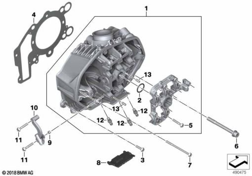

...But there's nothing to show where it fits, and how it goes in - ?
btw, I'm wondering if this thread's title is correct - aren't all of the 2017 RTs actually 1250?
Part 8 is the twist protection and it fits under the cylinder head by the #13 in the attached diagram. You push it up into the cylinder head from the bottom.
OK...never knew that thing had a name but it's still unclear to me from what particular twist that thing is protecting me, or the bike.
