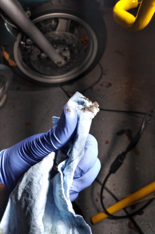

Apologies for the poor picture quality, but when I swapped to the Castrol transmission oil I took a picture of the rag I used to wipe the transmission plug magnet.
Doesn't look like any long stringy bearing cage pieces to me (yet) but I'm no expert. This much didn't appear in just 40 miles, mind you. I just didn't realize during the previous change how deep the area around the magnet is and hadn't wiped it out thoroughly.
Whoops, that wasn't the picture I wanted but I'll leave it up. Here's the other picture which gives a more clear idea of the color of the sludge and the quantity of sparklies:
