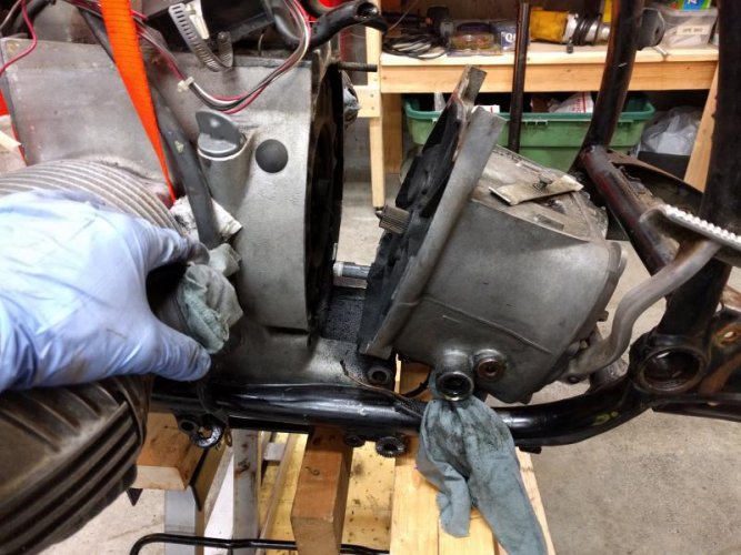

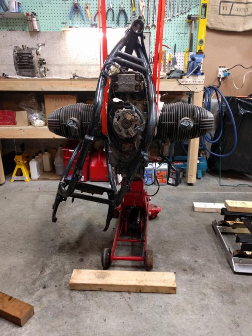

Almost down to the frame: just swingarm, driveshaft, front forks, any pressed bearings, and engine to go. Everything prepped, most nuts and bolts off, just need to read up on best practices for:
  1. Removing swingarm…axle, i.e. threaded…bolts? axle? Still in there after removing the 27mm nuts, don't want to force them until I know what they are.
  2. Steering stem removal—top acorn nut off, locking ring off, dust cap off, just stem and bearings, whacks a few times with a 2x4 and hammer and didn't budge. I guess I just need to…whack it more? Use penetrating oil and whack-a-mole?
Otherwise the four driveshaft nuts under the drive boot were easy to remove. Exhaust header nuts came off with some light heat and a light tap from a 2x4 and hammer (no fins damaged in the process, no special tool…although will order one for re-install). Front calliper holding bolt needed the ol' M8-bolt-threaded-in-bottom-then-pull to pull it out (trick from http://brook.reams.me/) Wheels off easy, fluids drained, centre stand was two bolts, subframe a cinch, and handlebars and full top assembly for them off in one piece. Only thing damaged tonight was the battery holder…so rusted, so corroded, nuts and bolts just twisting and spinnin'. Resorted to cutting the rubber mounts in half and pulling it out. Lower lag-bolt and nut style in bottom plate on frame still there…may have to grind out.
Tried by hand, then very, very gently whacked as tangentially as possible on a fin with a 2x4 and hammer…no budge. Knowing the aluminum will expand quickly, blowtorch in a constant moving pattern on the nut for 20 seconds, not hot enough that I couldn't touch for more than a second, then slight tap with 2x4 and they budged.

This Craigslist lift coming in handy. That's where I left it tonight.

Dedicated penetrating sprays didn't work. Banging about with a 2x4 didn't work. A little acetone and 60 seconds later out popped the fork steerer.

  • Remove swingarm…so uh yeah, I didn't see through all the grease that those swingarm pivot bolts have a 6mm hex socket in them…took one minute to unscrew from the frame.
  • Drive shaft: getting that out of the swingarm is apparently not so easy. My Hayne's manual wasn't kidding: that end nut is on TIGHT
  • Airbox: nice single bolt to pull one half off.
  • Steering lock: I tried to hammer out the rivet by tapping on the plate cover from behind but it wasn't coming out, and the plate was getting dinged and bent, so I stopped.
I tried to get creative with the driveshaft: re-attached it with the four bolts to the engine shaft (under the boot area) but I couldn't get the gearbox back into gear to hold it still. The tried bolting that end of the shaft to some wood and hold it in a vice. And then a larger vice. And then a 2-foot lever for the socket and…I don't want to screw anything up, so I'm going to wait for my mechanic buddy and:

Straight-up acetone with a little syringe applicator, 1cc and the steering bearing finally budged.
Driveshaft end nut…not so much. That thing is on tight. Maybe will have to leave it, bag it, and they powdercoat the swingarm with it still in?
