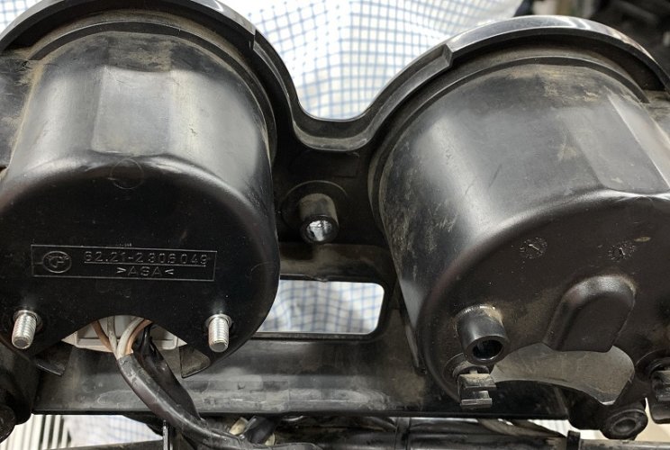

Got deep into the winter time bike work and decided to replace the Tach & Speedo lamps with LED's. Believe I've identified the four needed for the displays but after successfully extracting the housing for the speedometer came up against a BRICK wall getting the Tachometer out. Haven't broken anything yet but it appears the white housing of the tach has been glued to the dashboard support. (part description from BMW) If my assumption is incorrect could someone please tell me what releases the Tach from the dash? I've tried warming the plastic (sparingly/gently), sprayed a plastic safe CRC cleaner/lubricant into the crevice to no avail! I really want to get to those two old (dim) incandescent lamps and replace them with LED's.

The white speedometer housing slipped out easily upon removing two M6 nuts from studs securing it in the dash frame. Turning my attention next to the Tachometer I removed it's two M6 flanged nuts failing to literally drop out as the speedo had! I disconnected the dash wiring from the bike as it was my intent to inspect and clean ALL the wiring plug connectors as long as the nose fairing was off. I put the dash unit on the workbench and attempted for the next two hours to free the Tach from the housing. Assuming my best NCIS persona (forensic investigation) using a magnifying glass I discovered a trace of crystalline substance on the depth limiting step opening on the speedo side. Additional evidence that the speedo side had possibly previously been removed for the purpose of replacing a burned out lamp as the bulbs on that side were different brands. It's my theory that perhaps one of the previous owners or a shop mechanic splashed brake fluid on the dash during a front brake flush procedure, quickly cleaning it up so as to not mar nor leave a trace of the incident on the face of the dash but allowing a bit of the fluid to remain in the crevice between the bezel of the Tach and the dash support. (thus, my previous 'glued' reference) Because the front brake fluid reservoir is closer to the face of the tach than the speedo unit it may have received more of a drenching of fluid. It's my intention to proceed with care and gentleness trying to free the bond between the tach and the brittle dash support. I'm determined to replace the two dim incandescent lamps with LED's suspecting one may be burned out as the brightness on the face of the dial at night is not equal on the left compared to the right.IMG_2959Small1.jpgIMG_2960Smaller3.jpg

I've successfully extracted the tach from the dash support and WITHOUT breaking anything! Careful examination of the exposed mating surfaces showed NO melted plastic, no glue and a perfectly smooth surface. (I guess I just debunked my own brake fluid theory) What was in the joint holding up the disassembly was very fine grit, smaller than sand and more like fine valve grinding compound. Even after attempting to break the bond with CRC electronics cleaner/lubricant and then Alcohol it was the well known WD40 (with an application of GENTLE heat) that loosened the tach from the dash support! And yes, one lamp was burned out and proved that TWO points of illumination for the dial is necessary. Now on to ordering my LED replacements and am only pondering color, (I like RED) or if white, what hue?

Here's what worked for me:
Three simple tools: Mayo jar lid to support face of dash support
Press blocks for two exposed retaining studs
Fulcrum (LARGE SCREWDRIVER!)
Was gently and carefully applying a little bit of heat while putting pressure on the fulcrum and POP! The tach was out. The tight fit and grit held it in until I applied a little more 'force or persuasion'.
