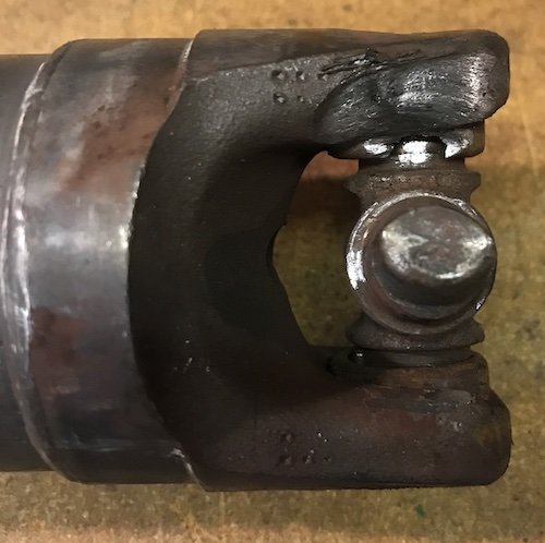

I went out to ride my '05 R1200ST last month and heard a lot of clattering when I let the clutch out. The bike has about 90K on it, and I thought it might be time for a new clutch. I started it taking it apart last week and saw that the front u-joint on the driveshaft had broken.
I can't figure out where or when the u-joint broke, I didn't feel or hear anything when riding. At least the bike got me home, thank you Motorcycle Gods.
The Clymer manual says there is a circlip that holds the drive shaft onto the transmission output shaft, and you can pry the driveshaft off with a bar or large screwdriver. Since the front u-joint is broken, I don't have much to pry against.
Do I need to remove the swingarm to get the broken u-joint out?
View attachment 90524View attachment 90525View attachment 90526View attachment 90527

Never done one on a Hex/cam. Pretty sure that the U-joint has/had been going bad for some time.
From the reading here on the forum, pretty sure it’s whole driveshaft time.
Good luck.
You need to remove the swing arm to remove the shaft, or to install a new one. The ST uses the same swing arm as the RT, and the transmission end of the shaft is too large to pass through the arm (unlike a GS/GSA). I would not bother trying to pop the shaft loose from the transmission until the arm is off.

I answered my own question and pulled the swing arm. Popped the broken u-joint piece off with a long tire iron. Since I'm in this far, at 90K+ on the bike I figger I might as well do the clutch too.
I'm sending the drive shaft to MSI in Green Bay. Based on other messages here, their $260 rebuild could be a better solution than Ted Porter's $760 option, or the BMW OEM $1100 option. I'll let you know how it goes.

Update: I got a call back from MSI, he says they can't rebuild this drive shaft. Not only did the u-joint break, but he says both the yokes are twisted too. He was surprised that I didn't feel any vibration on my last ride.
Apparently this shaft got so hot that the plastic seals melted and whatever grease was left in there went away, the metal got super hot, and broke/twisted. Once again, thanks to the Motorcycle Gods that I got home.
MSI says that BMW uses OEM "forever lube" u-joints but after awhile, the grease dries out. This bike is an '05 w/ 90K miles on it, so now I know how BMW defines "forever". :banghead
So it looks like it's Ted Porter time for me.
Bad news is it's destroyed beyond repair, good ness is Porter rebuildable is an option besides an new OEM from BMW
