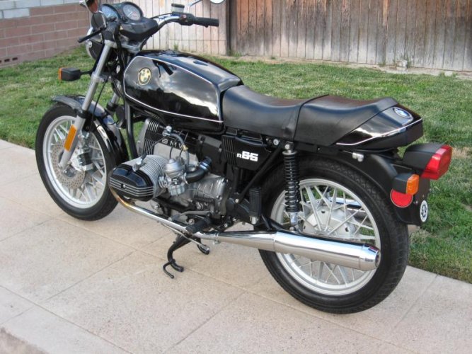

Finally finished the R65 restoration. I purchased this bike nearly 15 years ago, originally for my wife. My intention was to get it done sooner but a major house remodel and a multitude of other excuses kept it sitting in the garage. The bike was originally stored unprotected at water's edge here at the San Diego Yaght Club by the original owner so you can only imagine the corrosion and degradation from the salt air exposure. It was a mess. I did a complete ground up restoration except for the final drive, forks and transmission. Surprisingly enough the tank, seat and fender paint is original. It buffed-out beautifully. Complete top end with all new upgraded valves, seats, guides and rings. What a fun little bike! I have about 1200 miles on it since the rebuild and it's settling-in better than ever expected. I can't remember ever having this much fun - great experience and nothing short of a labor of love for all the hours invested. I'm including a photo link of most every process in hopes these photos will aid any of you thinking about doing a restoration or repair. I tried to capture most of the work in a somewhat organized tutorial format. Unfortunately I don't have a web site - that's my next big venture along with many more restorations...I hope. Love doing this. If you're interested ; after opening the link individual folders will be at the left of the blank screen for you to view. Many thanks go out to those that helped in the process; physically and spiritually - you know who you are. I'm a big believer in keeping these bikes running and on the road...nothing like 'em!

Lovely work, Mike. I had an '83 for years in the 80s, and my wife another '83 in the mid-90s, both were black. Your machine brings back nice memories!
These are such underrated bikes - especially the giggle factor. Life cruising at 5500rpm on the freeway is certainly alien to many airheads. But they are most fun in town, tight roads, etc.
jforgo,
Couldn't agree with you more. This bike is a kick in the pants in the local canyons. Very quick and responsive and the carve factor is nothing short of exhilarating. These 650 motors really like to spin and act almost like a 2-stroke. It'll run down the interstate at 75 all day long. I think they're very under rated and I'm a bit surprised they aren't more popular. Light nimble and quick - an important part of the family with strong blood lines.
Great job! :thumb
Should be good inspiration for me to get off my duff and do same with mine. :brow
I like the silver Brembos. Is that how they came or a choice (I assume its paint)? I may follow suit. It sure cleans things up down there.
