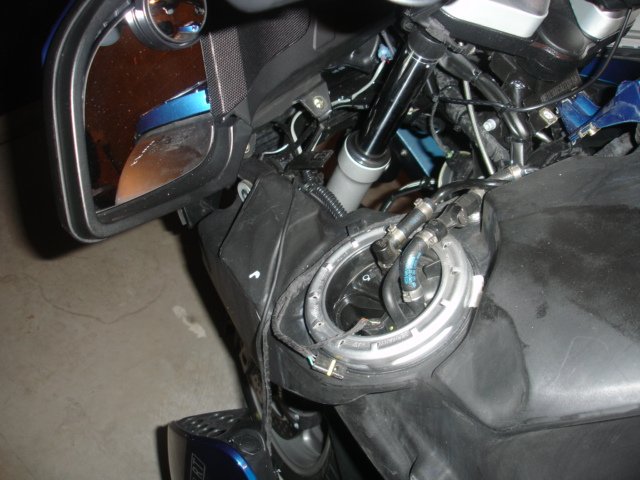

This thread describes how BMWs inept (charitably put) design of the fuel pump controller connection on most R12 bikes can leave you with a dead bike, especially if you ride in the rain. I am by no means the first person to comment on this (as a web search will show you) but most have talked only about how to fix it. Much of this thread is about how the BMW design is a failure waiting to happen, with recommendations on pre-emptive maintenance.
What happened to me? My 08 RT simply crapped out today in nice weather while going on an errand. It died and could be restarted, multiple times. Sometimes it quit again almost immediately or in a couple hundred yards and sometimes I could ride it 5 miles with no problems. My GS-911 showed a 10168 code, electric fuel pump failure, so I pulled the left side cover to examine the fuel pump controller and connections, a well known problem.
Let's start with a broad view photo to set the scenario. The silver circle in the photo is the well that contains the fuel pump controller. In the photo, the controller has been removed. Notice that the fuel pump controller/well is on a slope,at the front of the fuel tank and that the removed controller occupies the low spot in that well. Therefore, fuel pump controller connections are at a low point in the well where any water that penetrates will collect. A smart engineer would make a well with an electrical connection self draining so that any water which penetrated would also flow back out and not build up to short the connection. Really smart engineers wouldn't put the connection in a well, let alone a well at the front of the tank where heavy rain can reach it while riding. BMW's engineers aren't smart enough to have done either.

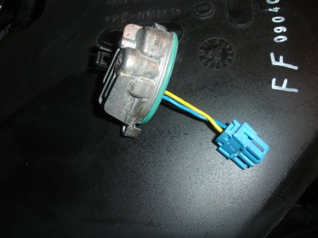

Now the Controller
Here's a photo of the original (silver metal housing) fuel pump controller from my 08 RT. The blue connector clips to the fuel pump connection at the bottom of the well. That connection point will be shown in more detail in the next post.
Note the gasket on the SIDE of the controller that is intended to keep water and grit that can collect in the well from penetrating to the connection to the fuel pump. This is a major design flaw that causes many of the so called fuel pump controller failures because it is has only SOME of the properties of a compression gasket like it should be. It lacks any vertical locator pin to keep the gasket in place and prevent it it from spreading to the surrounding ridge. It also is clamped by only the two controller screws and two clamping points do not define a compression plane. The one of my bike was partly adhered to the side of the well and had apparently spread when "clamped". BMW doesn't even bother to grease this during assembly despite the fact that silicon grease is widely used in many industries and applications to help ensure rubber gaskets seal properly on installation.
The somewhat hard-to-see black electrical connector connects to the bike wiring that provides power to the fuel pump controller. I see no issues with the design of this connector.

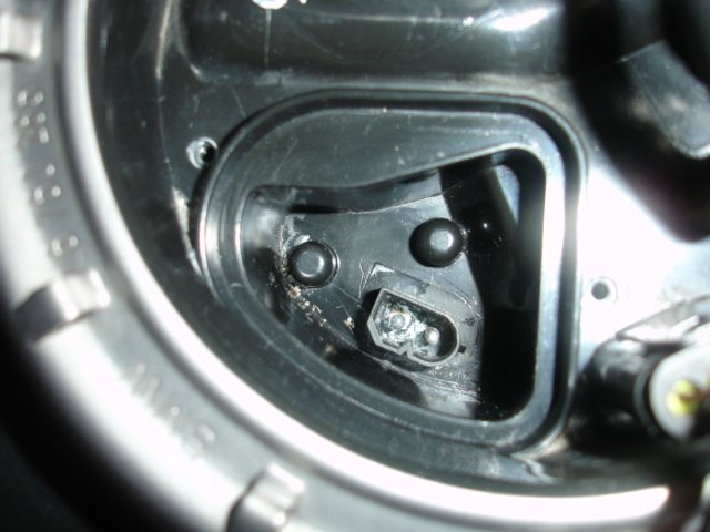

Closeup of Fuel Pump Controller Well
Here's a closer photo of the fuel pump well. Note the ridge that surrounds where the fuel pump controller goes. The SIDE gasket of the controller is intended to seal on the inside of that ridge.
Also note that the ridge does not go all the way around the controller, Instead, the wall of the well itself provides part of the sealing area. This is the reason that a proper compression gasket could not be fitted (it would have to be on the BOTTOM. not the side and would require a different well design). It's a first class design f**kup, IMO.
Note also the two metal pins surrounded by a ridge in the fuel pump controller well. That ridge around those pins is the only half way intelligent part of the design. Its purpose is to prevent water that gets into the well from getting over that shallow ridge and into the controller connection to the fuel pump pins. However, it is very inadequate. If enough water gets in, it simply flows over the ridge and penetrates the connector, causing corrosion. That corrosion may have my bike to quit (but later examination also showed the board inside he controller had a little corrosion and some of these controllers also apparently fail from heat overload.) I didn't measure the exact currrent drawn by the fuel pump but it is reported to be 7A, and that's plenty to help accelerate corrosion and too much to successfully put through a waterlogged, corroded part.
And because the well is on the low side, putting the bike on the sidestand increases the chance of water overflowing that ridge and shorting out the connection. A smart design would instead put a critical connection at a high point (in addition to keeping water out, allowing for drainage, etc).
You can see two screw holes outside the well for the screws that hold the controller in place. Those screws were also corroded when removed.
(I have since learned that a BMW replacement controller comes with 2 new screws and a new gasket)
What Happened to Mine and Why
In my case, enough water and road grit penetrated the controller well to cause corrosion at the connection at the pins to the fuel pump. (Later examination showed some corrosion on the controller board andd some controller are also reported to fail from heat overload)
That water and dirt penetration of the inner well and to the controller circuit board is prima facia proof that the design doesn't work. If the design was any good, the controller would work with the outer well full of water because it wouldn't penetrate to the pump connections
Most R12 bikes have a similar design AFAIK but I'm also no ultimate expert on all years and models. This can happen to yours if you ride in the rain (what probably killed mine) or are foolish enough to spray a pressure washer into the front of your bike. My bike gets washed about 3X/yr with a hose and bucket. Of course, if you live in the desert or never ride in the rain or wash your bike, you're not likely to have this problem. But I ride in the rain while touring unless it gets so heavy I simply can't see - I've got about 1000 rain miles this year- less than many of you, no doubt.
AFAIK, the only BMW response to this problem has been to make powder coated controllers and a couple service campaigns which would not have changed what caused my bike to fail on the road. The whole well needs a complete rework on all models, IMO. Certainly periodic failures have been reported on many models. (There is a website showing UK stats for the GS and well over 100 failures were reported in 2009 and that many already this year.

2) Bypass the controller entirely so the fuel pump is "always on". There are 2 ways to do this. One involves a bypass cable that connects to battery and the other involves cutting the blue connector with its wires off the controller and patching it directly into the power supply to the controller.
3) Install a new controller if you have one.
I've decided to replace the controller, to do 6K inspections on the controller well, and to carry a spare controller on the bike. Looks like a little can of DeOxit would also make a useful addition to the toolkit.
Commercial Source of a Bypass Cable
Here's a link where you can get a pre-made bypass cable. These are cheaper than a controller and work fine. (The controller is about $150 and the cable about $25) Just remember to unplug it when you stop riding or your fuel pump will RAPIDLY kill your battery due to the current it draws!!
http://forums.bmwmoa.org/showthread.php?t=38757&highlight=fuel+pump+bypass
You can also make one of these by splicing the blue connector cut from a dead controller onto any wire that you can connect to battery or an outlet rated at 10A or more (like the front accessory outlet on my 08 RT but note that many GS bikes and earlier RTs only supply 5A at the front outlet so will not run the 7A pump reliably from that connection point).

My question is, what's directly below/behind the "well" that the controller sits in?
Could a few small drain holes be drilled in the bottom of the well to prevent water from accumulated in there? Adding drain holes has several times solved similar problems for me over the years. I remember I bought a new Volvo in the mid-80's and every time it rained hard the taillight housing would fill would water and blow out the taillight/stoplight bulbs. A few strategically drilled drain holes solved the problem.
It looks like drilling a drain would simply pentrate into the interior of the fuel tank so drilling is a recipe for one of several worse problems.
If someone knows otherwise, please say so because it would be an easy design improvment that would negate the need for 6K inspection of the controller well.
