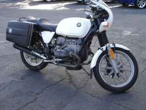

Greetings Airhead Forum! Going to pick up a 1978 slash-7 in San Juan Capistrano tommorrow. With my m/c nut neighbor Marc, looking forward to getting her home, cleaning her up a bit, and riding her this summer! Right float is leaking a bit, needs a new gas cap, and some light rust here and there...beautiful bike! Now the garage has a dirtbike (CRF-230F), an oilhead(R850R) and now, this beauty....think I'm hooked!

AFAIK, no '78 came with anything but chrome pipes. The R65LS ('79, IIRC) came from the factory with matte black exhaust (headers and mufflers), but that's the only '70's era bike that did.
PHP:
Looks like the exhausts were painted over: there's chrome underneath.
