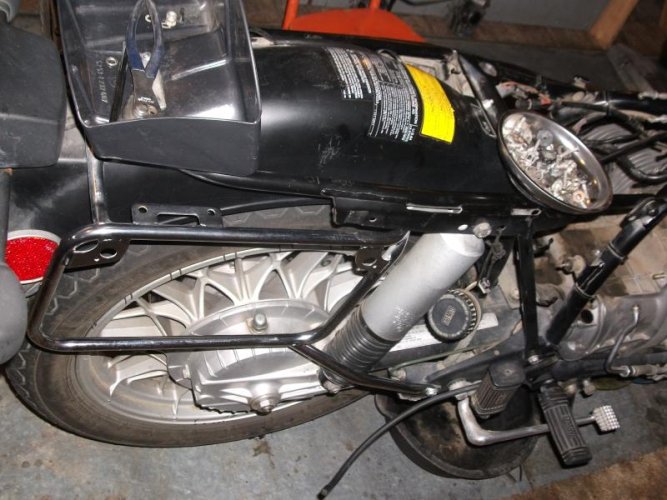

The way she looks now.

The Bike starts again tomarrow. This is what it looks like now.
