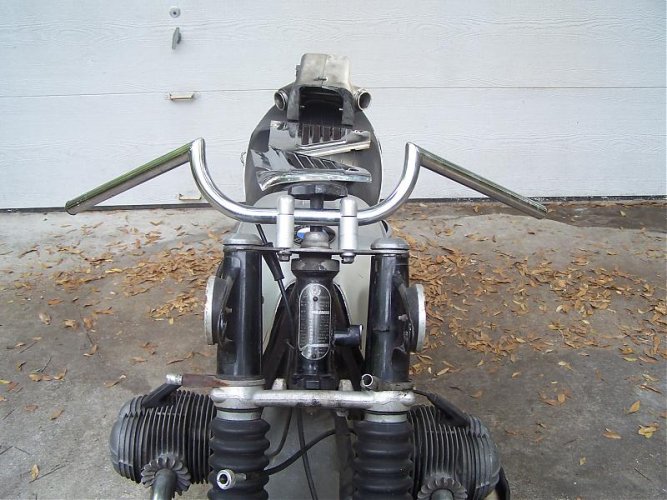

Thought the cafe crowd would enjoy the unique application of clubman bars.:brow
