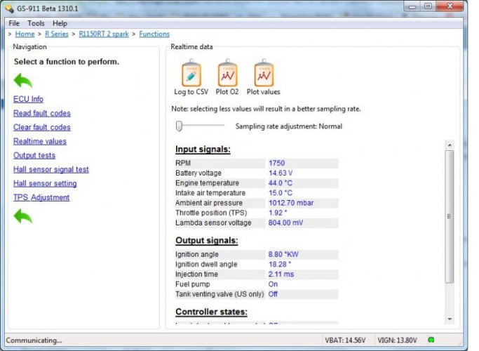

    Hi Rick,
    I just removed and reinstalled my ABS unit while replacing my alternator's regulator so that it properly charges the odyssey pc680 battery. I don't think you need to change out the new battery you bought. It sounds like you have a real problem in the ABS unit. Out of curiosity, which battery did you buy?
    I don't know the ABS unit very well, but I just used my GS-911 to read ABS codes and to perform a full pressure bleed-down test that the GS-911 supports. I will take a screen shot of the status data which will give you an idea what's going on.
    The computer is looking at wheel spin from the wheel sensors, monitoring internal hydraulic pressure with sensors it has and watching for the brake switch to OPEN. On some bikes the brake's switches close when you apply them, on the R1150RT, the contacts open when you apply the brakes.
    If the wheel rotation sensor or connector has a problem, it will fault. I'm told that any brake fluid spilled into those little connectors will damage them. They are the small ones on the top of the ABS. Carefully remove each connector and look inside.
    If the brake switch or wiring has an intermittent open, that may cause a fault. Doug Raymond who made these (http://www.mac-pac.org/wp-content/up...agram-V3.1.pdf) great schematics told me just recently that it took him a long time to find an intermittent switch.
    What color was the fluid when you bled the brakes, and how particle filled was it? Look the rubber lines over from end to end, others have seen bulges. If the line bulges under pressure as the fluid warms, that could trigger a fault.
    I would certainly look into borrowing a GS-911, I'd loan you mine if I were closer but I use it quite often.
    I'll get a screen shot of the ABS status and add it in a few minutes.
