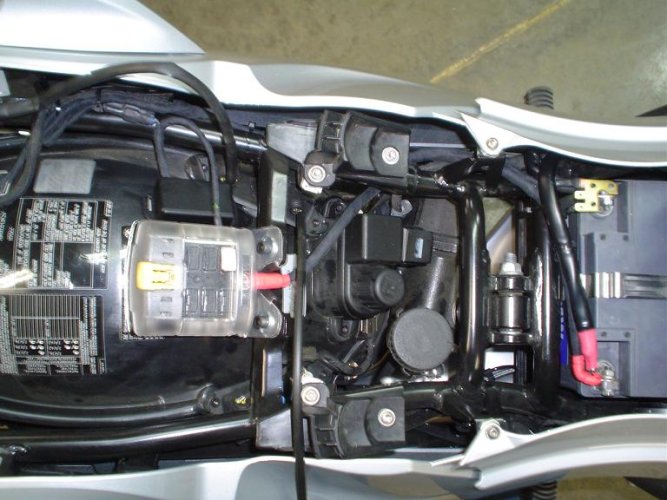

    First, I would like to thank all of the folks who gave me suggestions. All of them combined gave me the idea for this fix to my problem. Winter finally released it's grip and spring has come to the interior of Alaska so I was able to finish this. Here's what I did.
    Using the wiring diagrams, I ignored the German words (since I can't read them anyway) and managed to find the switched power wire coming off the ignition switch. You can see it in the first picture. Its the green wire with the white stripe. Its located under the black plastic cover just in front of the battery. I used a wire tap to create the positive "+" wire (red) for the aux fuse panel and ran a black wire from the negative battery post to create the "-" wire. I passed both of the wires down through the frame on the right side and followed the existing wiring across the bike to the tail compartment. There is a channel already there to pass all your wires into that compartment. I decided to use the BlueSeas fuse panel which fit perfectly in there. Initially, I had it sitting on a bracket but later removed the bracket because it made it too difficult to get in and out. Instead, I just padded the compartment and it seems to be just fine. I ran all of the accessories to the tail the same way and bundled all of the wire together to make a "J" harness to give me enough slack to lift the panel out of the way to release the seat. Again, check out the pictures. (I hope they make it or all of this will seem pretty silly) In the end, each accessory had it's own circuit and it's own fuse. It can't get much simpler than that and now I don't have to depanel my bike if, for some reason, I have an electrical problem half way to Prudhoe Bay. Oh! I almost for got to mention the extra white wire on the "+" terminal. My PIAA 510 lights have a relay that is controlled by a switched power wire. Since the entire panel is switched, I decided to make it think it was on the original wire harness and tied it into the first place to get power. I then made the positive and negative connections to the fuse panel as usual to power the lights. I hope this has been helpful to a few of you. The idea can be applied to any bike. Please let me know if you have any questions and I'll try to help. Thanks again everyone.
    OK, I'm having some difficulty attaching the pictures. I have them scaled properly. All four of them are 67-90Kb and are 800x600 but it seems to lock up when I try to attach them. I'll continue to try another time
    Last edited by Yellowjacket; 05-13-2008 at 03:41 PM. Reason: Technical difficulties attaching the pictures
  15. #15
    Yellowjacket
    Guest
    Let's try again
    Ok, I reset the keyboard actuator and I think it will work this time. The green wire with the white stripe can be seen in the middle of the picture. In the other pictures I've show the panel installed, removed to gain access to the seat release, and with the cover off to show the connections. Again, I hope this will be helpful to a few of you. I know I'm liking it quite a bit!
